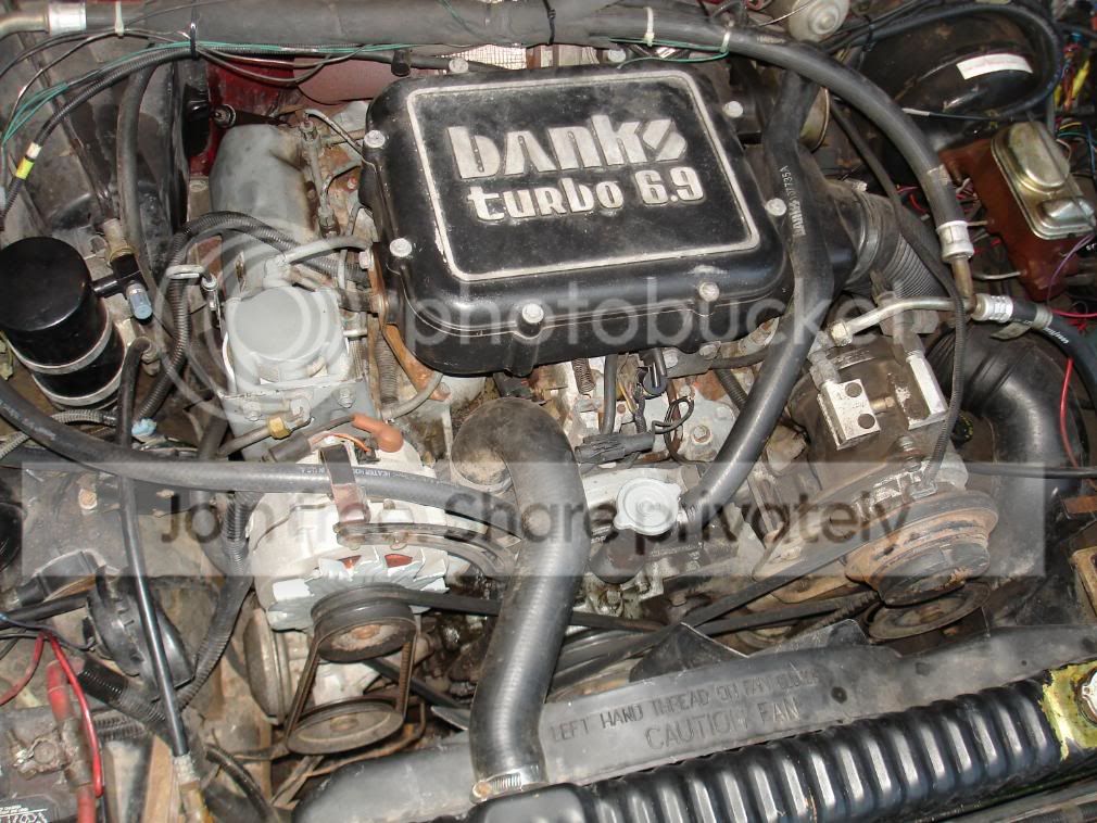

dave got a pic of the top of your engine that you can show?
Old Dec 27, 2007 | 08:05 PM
Dave Sponaugle's Avatar
Dave Sponaugle
Joined: Nov 2003
Posts: 21,285
Likes: 15
From: Nutter Fort, WV
That is not my truck or engine, just downloaded the pictures for reference.
I think it is an ATS kit, cost about 1100 dollars.

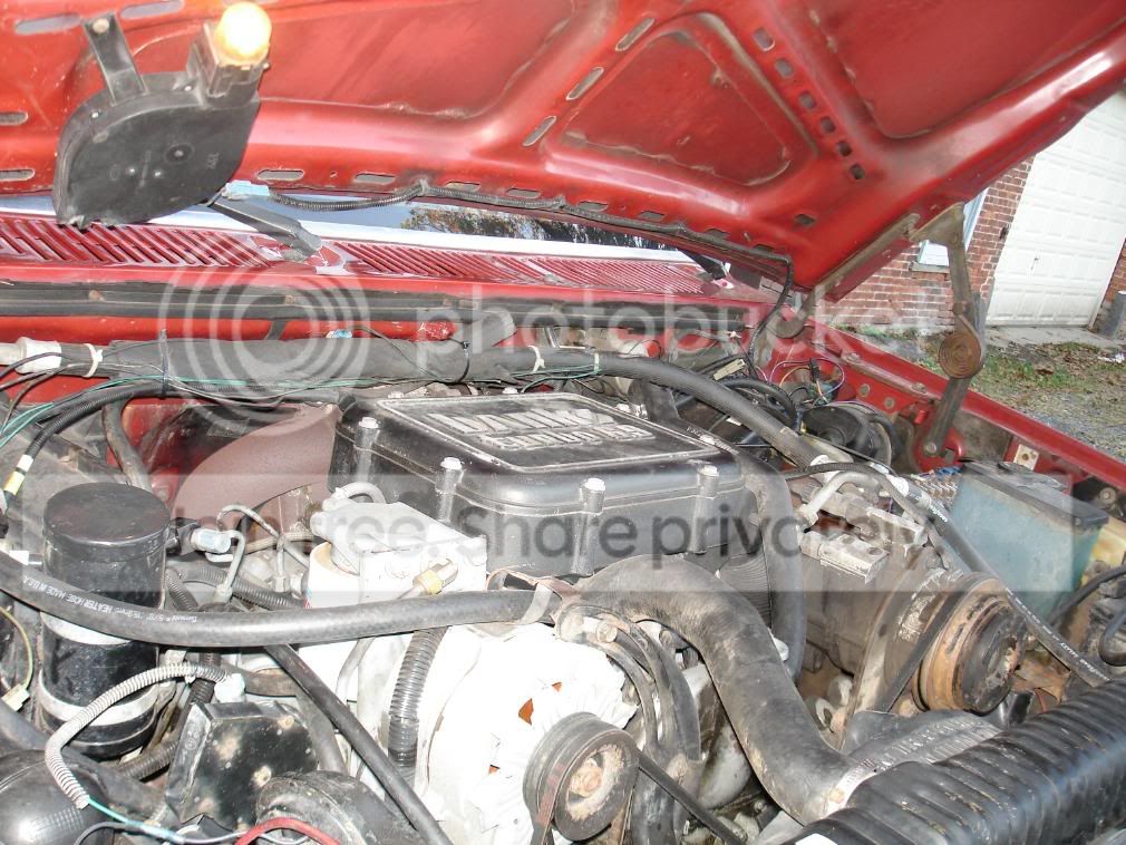

My engine looks like this, and I love to show it off.

damn nice engine.

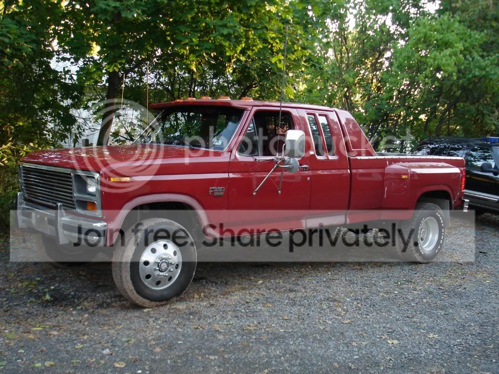

here is a few of my truck and engine
not as nice as yours but i havent had the truck that long
still need to figure out why it has a alt. from a 90 f-350

Getting ready to turn over 409,000 miles this week sometime.
