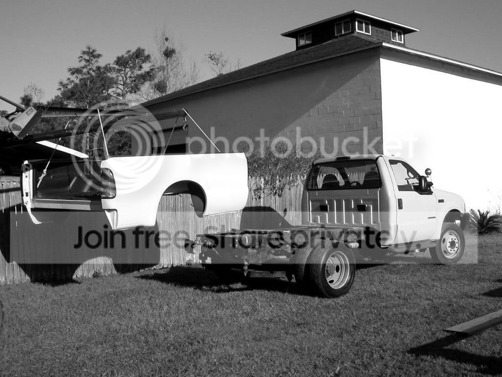

Got ya both, thanks, I don't understand where he will hook it to? Another way would be to chain, strap, clamp 2 long 4X4"s to top edge of bed going left and right to be supported on 4 barrels blocks or what ever? It is heavy and the lower part of bed will not support the bed. If you look at my post here
https://www.ford-trucks.com/forums/6...y-f-550-a.html
You will see how I did it with 2 people and a great machine
