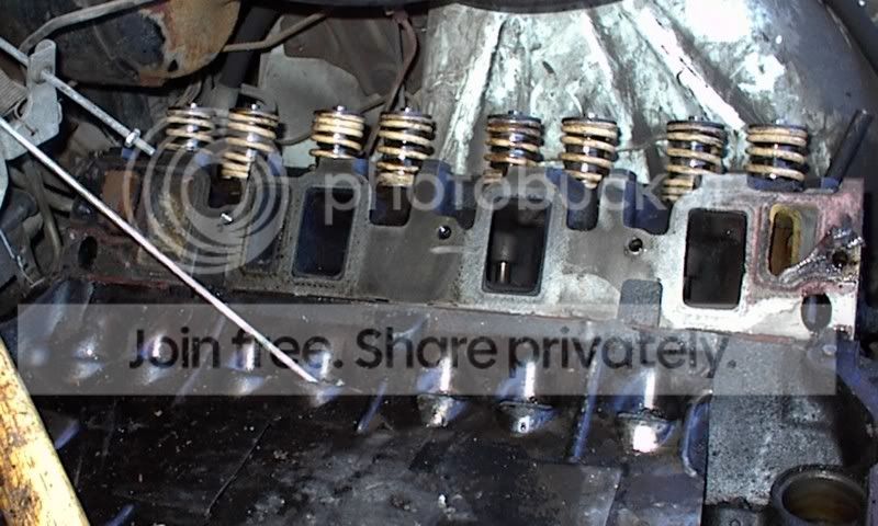

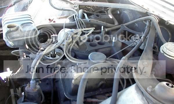

After taking cared of a few errands, and a few more honey-do's, I had about 90 minutes to get through this:
Four stinkin exhaust manifold bolts left! The last time I tore down a T-Bird engine, it was out of the car:
Hey Bobby, it looks like #8 had a gasket leak. In person the residue had a greenish tint, you couild see where the gasket failed. Probably the reason the car was parked:
Overall, I have a good feeling about these. The odo had 77k, the pushrod ends were still round, the intake ports looked like she was running fat, the rockers and shafts LOOKED to have minimal wear, the valve tips looked pretty square. The cylinders did have a slight ridge, not the worst I've seen.
I had big plans for the day, got skunked. I'll go back after work tomorrow. If y'all see something you gotta have, email the addy in my sig. This car will probably be crushed next week.
