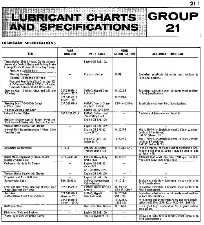

Since I recently (within the last few months) got my '64 on the road, I've been doing the usual routine maintenance, getting the truck back into good shape.
In the shop manual, it instructs you to lube several components such as the knuckles and joints with "Engine Oil - 10W". I've never seen anything on the shelf labeled just '10W', instead always that followed by 30, 40, you know...
So what is it? And what should I be looking for? I'm not knowledgable on the entire oil weights and numbering...

There is a 10W motor oil out there. It maybe hard to find. I have some made by Pennzoil. I have an air compressor that uses it. You will probably have to ask for it. I have not bought any in several years. I cannot remember where I got it at. You can also do a little research on motor oils on the net. There is probably a suitable substitute. http://www.answers.com/topic/motor-oil-2 This site goes into oils in considerable detail. You may want to check it out.

Matt, Going from memory, and don't know how accurate your reference is, but your truck was built before multi weight oil. What was most common was straight 30 wt. for engine, and 90 wt. for trannys and rears. 10W40 or 10W30 have been used for years. It has only been recent that 5W30 and 0W5 synthetic oils have come on the scene, and to be used in engines built much much different than the one in your truck.
We now have gear heads running 20W50 because they think they are getting something more. No one has proved either 10W40 or 10W30 as being bad for the older engines, but thicker is better.

Best is in the eyes of the beholder. 10W30 is still readily available and has worked well for years.

Yeah I use 10W30 in the engine. I just wasn't sure what '10W' single-grade oil was.

Matt, For kicks & giggles, would you go back and look to see if it is 10W?
The only time that I recall the W being used is like 10W40 or 10WXX not just 10W.

Your local tractor supply store will have 10 weight oil.

Here's the section of the shop manual scanned in:
