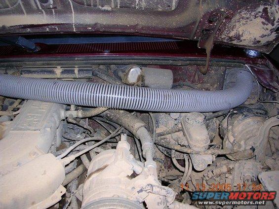

The other day I was out 4 wheeling and a mud hole jumped right down my Bronco II's throte. As many of you probably know the intake box is right next to the pass. side headlight. A great place for a goldfish but umm ... So here's my question ... has anyone had this problem before and how the heck do I remedy the situation?? I will try to come up with an idea .. a cheap (yanno I mean free) way to fix it but if anyone has any ideas of they're own please let me know.

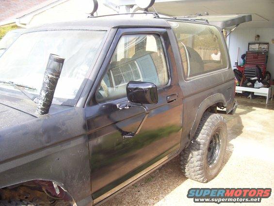

some vac hose,
and a lays stax can, with some duct tape and silicone, and a candle holder thingie.
ran the hose to the rubber intake hose. worked great..not the best when it was raining outside, but i never sucked in any more water.
and painted.

yea, i cut the stock flares off. the flares on the back are from the front.
