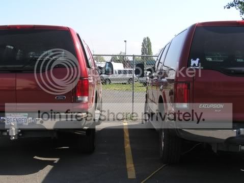

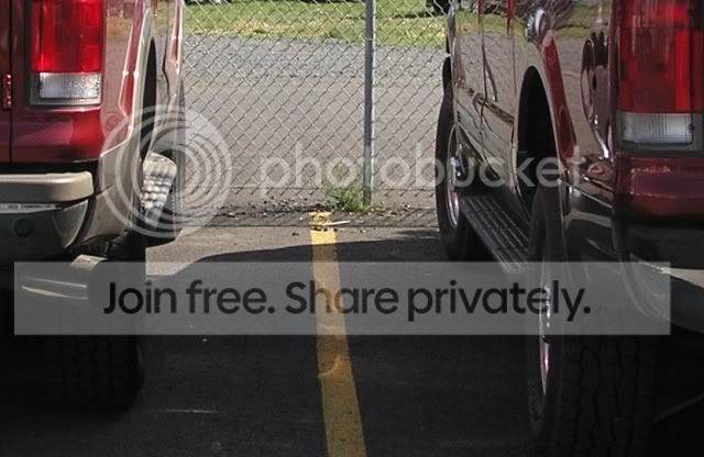

For comparison sakes, here my Ex with the spring upgrade sitting next to a 4x4 Ex with stock springs.
Look at the mirrors...
A closer look...
And a look at the wheel well openings...
Stewart
PS - Mine is the red one....
