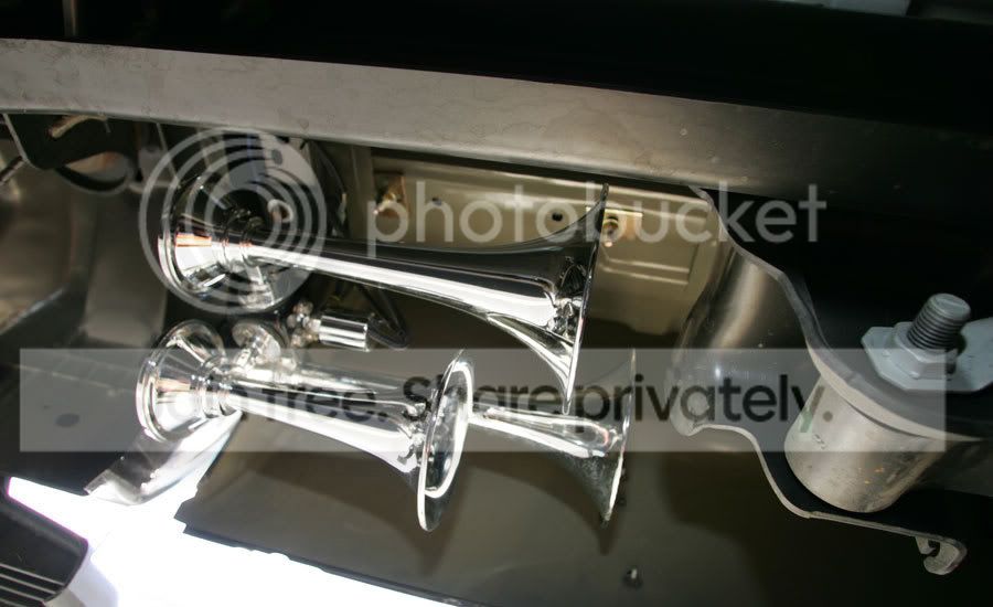

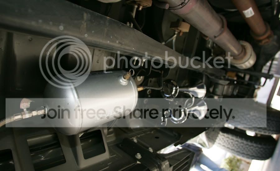

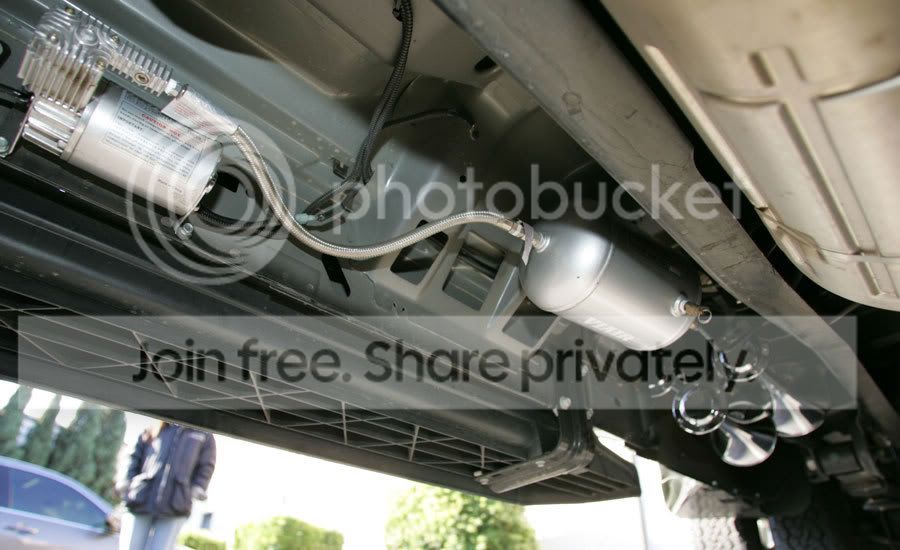

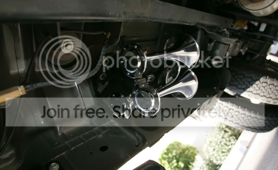

I have the 3 Chime Chrome Detachable Conductor's Package: http://www.hornblasters.com/products/details.php?item=CHR3D3G28
<?xml:namespace prefix = o ns = "urn:schemas-microsoft-comfficeffice" /><o></o>
They are VERY LOUD! I did not buy them from the link above. I purchased the kit at a local truck supply store near me in southern CA and had them install them on my truck (cost $600.00 installed). The Tank, Air Compressor, and Horns are all installed underneath the passenger side truck. The Horns are facing the back of the truck so water, mud, etc. does not get forced into the horns while driving in bad weather. I LOVE THESE HORNS! They are worth it! I can post pics if you would like.

Ok, Here are the picks of the Horns on my truck. I forgot to mention I also used the upfitter switch #4 to switch between stock horns and the air horns when I push the horn button on the steering wheel

looks like a great install... thanks for the pics.

Very clean install
