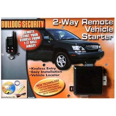

Yeah I've got a thread running about opinions on my new sig. A friend made it for me.
And yes, my starter has keyless entry too. It's a Bulldog Securities Deluxe 200. Looks like this:
It was the best one they made when it came out, and I believe retail was around $200-300. I bought mine on ebay about a year ago for around $70 brand new. There's a few up for auction right now:
http://search.ebay.com/search/search.dll?from=R40&_trksid=m37&satitle=deluxe+200 +bulldog&category0=
They have since come out with a Deluxe 500, has a few extra small features that mine doesn't have. There's 1 ebay auction for the 500 right now:
http://search.ebay.com/search/search.dll?sofocus=bs&sbrftog=1&from=R10&_trksid=m 37&satitle=deluxe+500+bulldog&sacat=-1%26catref%3DC6&sargn=-1%26saslc%3D2&sadis=200&fpos=ZIP%2FPostal&sabfmts= 1&saobfmts=insif&ftrt=1&ftrv=1&saprclo=&saprchi=&f sop=1%26fsoo%3D1
Retail is $170. Directwholesale.net is the website that Bulldog uses for selling their products:
http://www.bulldogsecurity.com/ (click Starters --> Deluxe starters to see the Deluxe 500)
Whatever you end up doing, I suggest buying the t-harness. I didn't use it, figuring the extra money wouldn't be worth it... TAKE IT FROM ME!! Buy the t-harness. Installing this thing without it was a huge headache. Took me around 6 hours.
http://www.bulldogsecurity.com/ (click t-harnesses on the left side)
I researched a good amount before deciding on this starter and found that Bulldog was up there being near top of the line for remote starters. I'm very satisfied with my purchase, and their customer service is AWESOME! For a while I had the supervisors DIRECT number, and called him several times over a few days because I was having trouble with the keyless entry. Turns out I installed in wrong and fried the internal relays in my unit. He gave me an address and I shipped it to them to get repaired FOR FREE! That's the definition of Grade-A service in my book. Good luck Mike.
