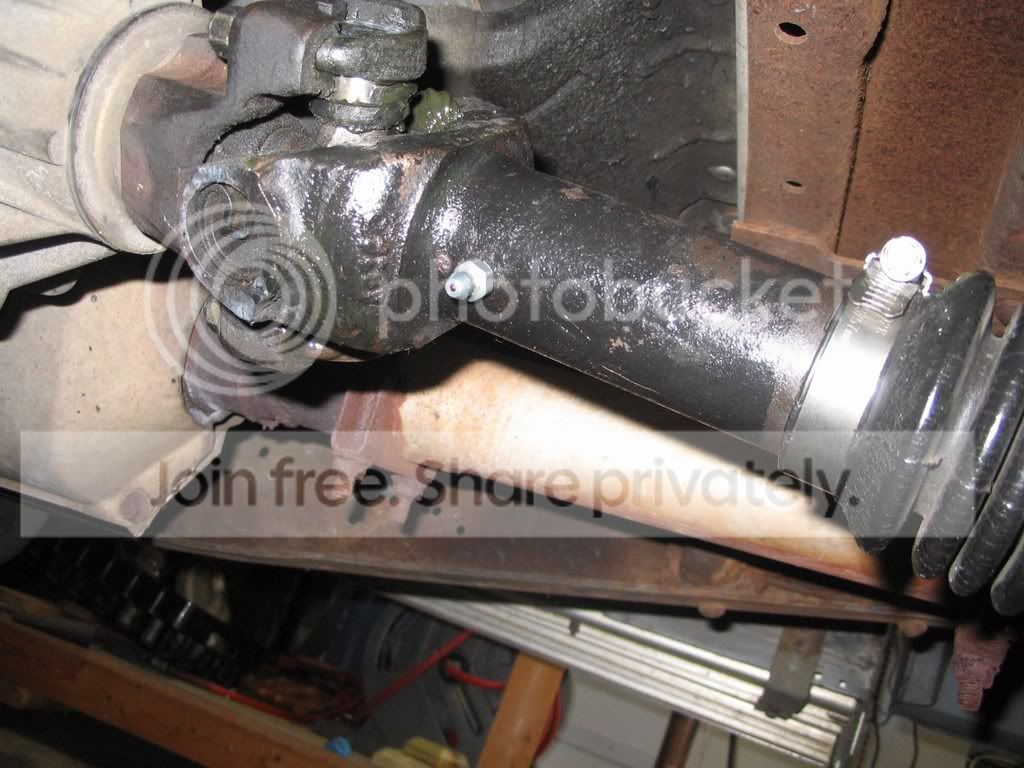

I also had the problem of the sticking slip joint.
Got tired of pulling the driveshaft to grease the slipjoint.
Drilled and tapped it to accept a grease zert.
Now when I do an oil change, I give this zert a
couple of pumps of grease. No more slip joint clunk.
