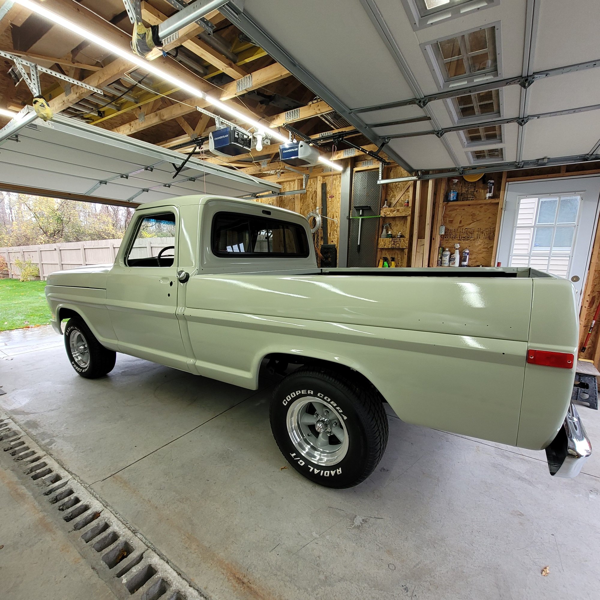

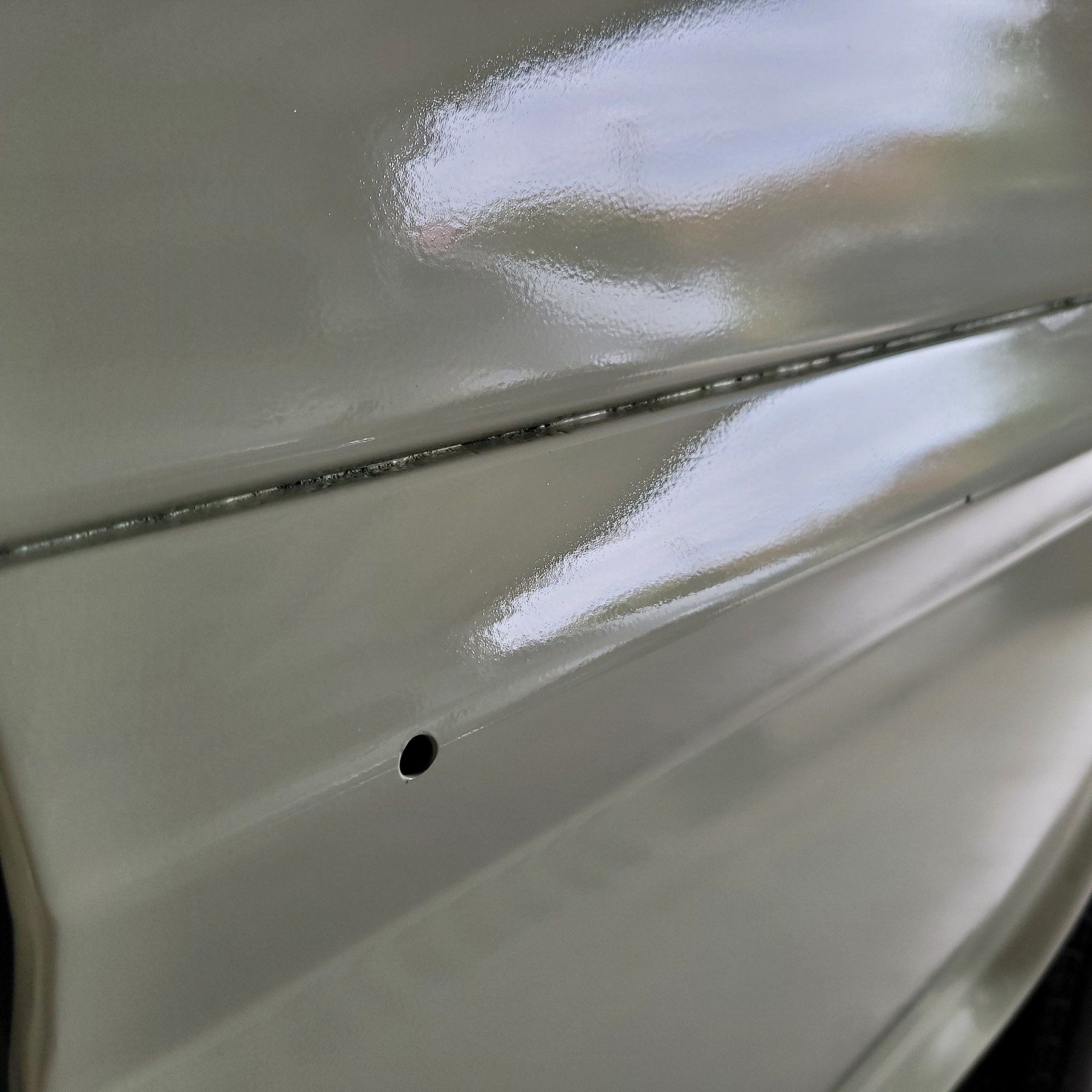

i guess i was so up in the air of what to do i just left clean. no weld no seam sealer. i was concerned it would look like this again after a few years
so i left clean and painted. now im second guessing i used rust mort it was primed for about 3 years and thats not rust its just the pitting showing through and the was the paint laid down. you jave to get up close to see this as this is a close up picture. stand back it looks fine
