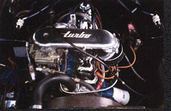

get a t-3 and clock it so the exhaust dumps into the top and the outlet blows straight up. Thats what i had on my 250 maverick
