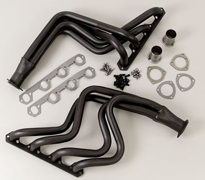

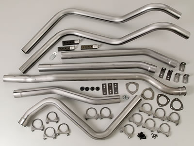

I was hoping to find a pre-fabbed 2.5" exhaust but that doesn't look like it'll be in the books. So all I could find was this Hooker dual 2.25" kit. It's all mandrel bent so I'm thinking it will be better than my dual 3" crimp bend exhaust I have now anyways. I've always thought 3" was too big for my 302 anyways (wasn't me who put it on) and my exhaust now is way too low and ugly looking for my taste. Does anyone have any experience with this kit or suggestions? I'm wondering how much this is gonna change my exhaust note as well.. less deep?
I do need some flexibility as well, because eventually I will be adding cam/heads etc.
2.25" Kit - HOK-16565HKR
Flowtech Headers - BIG-12502FLT
Thanks in advance, guys.

That looks great yea 3' single would be okay on the 302 thats a little to big still 3' dual is way too big dual 2.25 or 2.5
