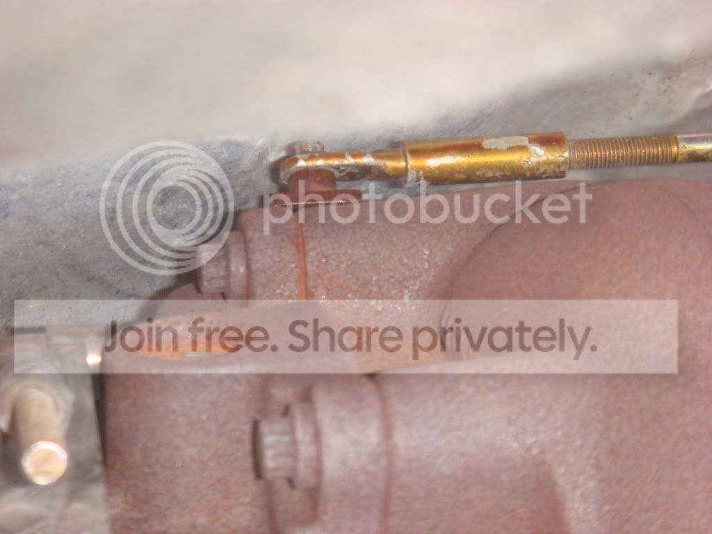

im putting in my WW today...where exactly is that clip that i have to take out and not lose..if anyone has a pic that would be great too

i did mine friday and the only clip is the c-clip that connects the waste gate. they`re is a slide clip under the turbo, but you just slide it towards the driverside it doesnt come all the way off.

The only one I know of is the same one I lost when putting on my ATS housing. It is located at the back of the waste gate rod.

Your best bet is to get a magnet of some sort and a set of picks like the ones a dentist uses. I had no magnet so mine went flying. Lucky for me I had an old carb in the shed and it had the same size C clip.

after you get what ever you use to push the clip off with in place..wrap a white rag around every thing and push it off..the clip should stay in the rag..
