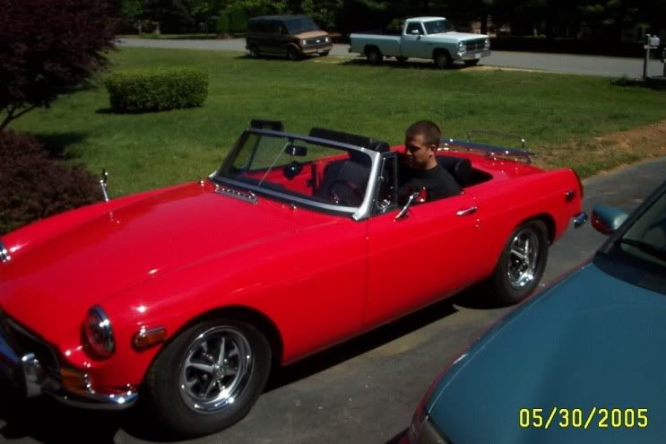

Red is a semi-translucent color in that if the color underneath is not consistently the same throughout the vehicle, it will show through. If you're going with a bright red, use a white sealer for some extra kick:

Solid red ?...
Since when?
My guess is you guys have never blended a panel......

I'd venture to say he'd have much better results starting with a like color primer/sealer over everything. For a repair, perhaps a blend would be appropriate. In this case, I wouldn't say so. To expect to spray directly over yellow, primer, and who knows what color on the front fenders, good luck with blending covering everything.
