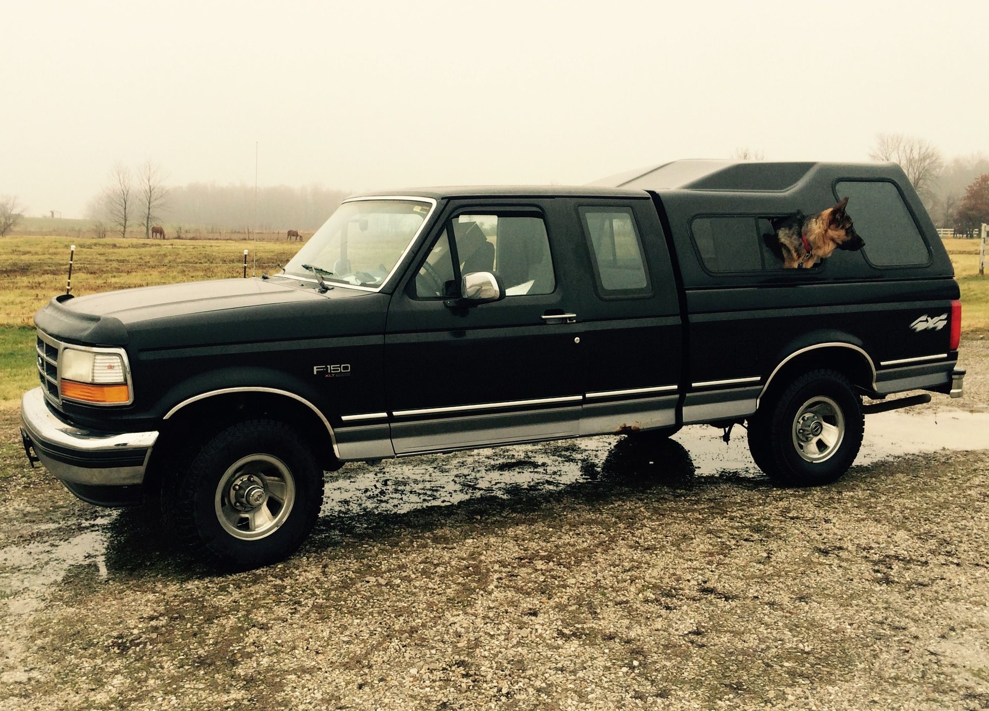

Necro posting I know but where we are now:
1995 F-150 XLT Short Bed, Black / silver two tone Trailer Towing with 3.55's with a tall black capper.
180K and owned by me since 1998 with 16K, two owners.
5.0l stock innards with K&N, Tricked Jacob's Mileage Master ignition system incorporating the coil trigger from an older Jacob's unit so I have two complete ignition systems by swapping the coil wire location.
Shorty headers through the original Cat to a stainless catback exhaust. All ECU sensors are new as are water pump, thermostat and 14 lbs cap , 130 amp alt, MSD Super Conductor Ign wires with heat boots. 14 btdc and Motorcraft copper cores one step colder and side gapped to .55 . '98 explorer 4 hole injectors. I have taken this rig from 12 ->14 mpg to 18 city and 22+ highway.
