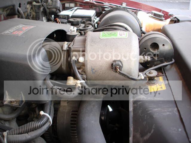

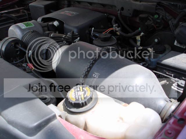

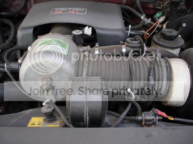

Hello everybody,
I would like to install a cold air intake, but since i drive on LPG (Liquefied Petroleum Gas) i think it is going to be difficult, because the gas vaporizer is in front of the throttle body.
Is there a solution ?
Pics included
Thanks
Pat

Looks like you won't benefit from one. It already draws in cooler air from the fenderwell and the restrictive silencer tubing has been replaced with the LP elbow, so I wouldn't waste any money on one myself. Maybe just get a stock replacement K&N element.

The Air filter canister can still be a restriction. there are some who enlarge the snout going into the fender to a 3 in pipe. Be cautious to get the correct filter. I have the same air filter box and the K&N restricted the entry down to the point the truck ran poorly. Maybe it is just my good luck working for me.

Sorry to digress here. Watch for the mounting depth of the filter of whatever element you choose. I experimented with my airbox by cutting open the front during the winter. Since it was cold I did not have trouble with heated air. Ran quite a bit better. Summer came and killed it at slow speeds. Above 100deg inlet temp and the ECU cuts back fuel. above 125 pulls back timing. I saw the 125 deg, but usually about 115 at a light. I put my cutout back in place and modified the piece going into the fender. Cut it off and replaced with 3 in plastic tube. I have a plastic welder so made it feasible. Was the mod worth it??? I don't think so. I did mine because apparently I have the wrong K&N which restricts the opening, and I enjoyed the experiment. Plus I have removed the restricting silencer LXman noted.
The pics indicate this is a street machine. As others already suggested, the K&N would do you fine.
