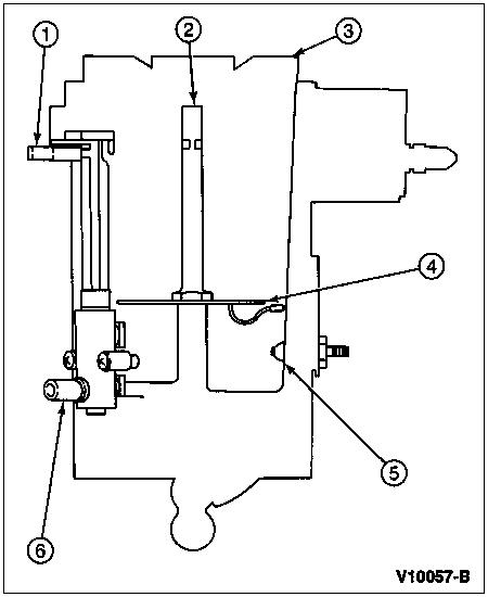

Duck, Here's the only thing I have that tells me what is what. The Restricted filter sensor (Vacuum) isn't listed but.......Maybe you have an older filter housing or the wires in the dash are crossed. Strange?? IDK.
<TABLE cellSpacing=0 cellPadding=3 width="70%" border=1><TBODY><TR><TH vAlign=bottom>Item</TH><TH vAlign=bottom>Part Number</TH><TH vAlign=bottom>Description</TH><TR vAlign=top><TD>1</TD><TD>—</TD><TD>Water Drain Lever (Part of 9155)</TD></TR><TR vAlign=top><TD>2</TD><TD>—</TD><TD>Stand Pipe (Part of 9155)</TD></TR><TR vAlign=top><TD>3</TD><TD>9155</TD><TD>Fuel Filter Housing</TD></TR><TR vAlign=top><TD>4</TD><TD>—</TD><TD>Heating Element (Part of 9155)</TD></TR><TR vAlign=top><TD>5</TD><TD>—</TD><TD>Water Sensor (Part of 9155)</TD></TR><TR vAlign=top><TD>6</TD><TD>—</TD><TD>Water Drain (Part of 9155)</TD></TR></TBODY></TABLE>
