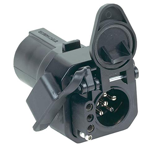

the stock truck plug has 7 blade terminals not pins.I bought my adapter at murrays as the stock flat plug I removed to use the wires for my tool box.They also make an adapter to go from the 7 blade to a 6 pin that also has a 4 flat pin. both of these adapters are simple plug ins.

This goes in to the 7 blade, or RV connector that your truck should have. It gives you the 6 pin connector and the 4 way flat connector. This is the one I have and it works great and will work with the vast majority of trailers out there.

thats the one . It runs about 25.00 around here and I have seen them at both pep boys and murrays.
