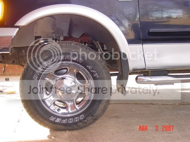

Hey Tj it depends on your rims and tires, as to if it will rub or not, I just installed the 2"key and rear block lift on my 2001 F150 with the 17x9 DC1 rims and it looks great, But the tires are a tic big and rubs a little, so Im going with the 2" body lift as well..Im trying to decide between the 2" or 3"..the new keys feel like the stock ride, just get a set of 2" extended shocks, procomp makes them, I have,nt drove mine yet with the total setup, but the 2" torsion lift and 315/70/17 loooks sweet, I;ll post pic soon, heres a pic of the stock tires 265/70/17 with the 2" keys and rear lift installed, its at a shop right now just looking perty with the wheels and tires waiting on the body lift, Im worried the 3" will be to much for a good look over a more factory look of the 2" body lift..but it will be close..

this is a before
this is after with 2" level kit
front after level kit
with the new tires, ive removed the mud flaps and the tire barley touches where they were mounted, and they hit the front bumper valance thats with the 17x9, 17x8 I might of been ok..cant wait to get pic up..
