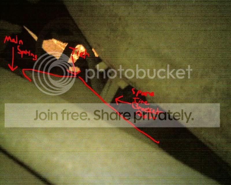

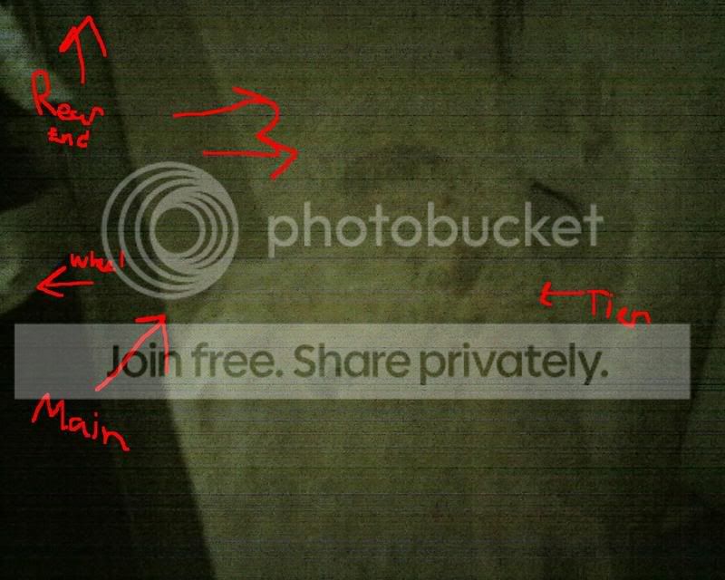

ok, so i have a problem. One of the tiers of my leaf spring (drivers side rear) appears to have snapped and slid over (see pics). Any idea how much leafs are and how the hck this happend. Just to not... i wasnt messin around in the truck.. noticed it wen i hit a slight bump and u could hear the tir hitting that spring.
If you can't read my writing it says "Main Spring", "Spare Tire Bracket Bolt" (the bolt that secures to the bed of the truck) and "Tier"

yeh, I think i'm going to take it to the mechanic tonight... have him put some new leafs in... I looked at prices online, i found an average of 100 a piece. Has any one seen this problem before? And also, i compared both sides of the truck i could cound 3 tiers and on the side NOT broken i can cound 4... dunno what the problem is.
