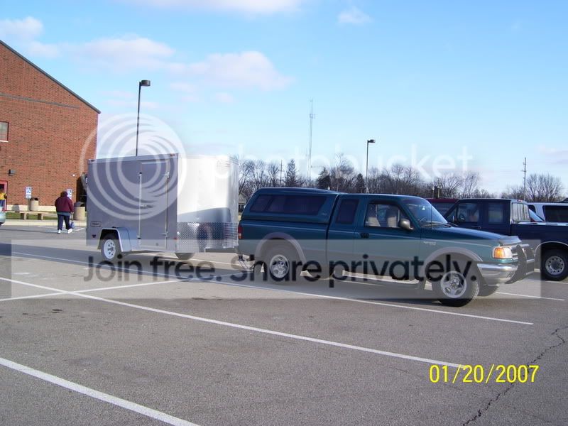

got a new trailer last weekend, a 6x10 haulmark. going to use mainly for my wife's craft shows. thinking of equiping the taurus as a second tow vehicle, the taurus is rated at 2,000 towing max, the trailer is 1040 empty. as long as i dont go over 2,000 i should be o.k. going to weigh it when i load it to see how much it will be before i try it out. has anyone pulled with a taurus sedan before? im thinking i need to get a small van if im going to pull it much with the car, they were never known for long trans life, anyhow heres a picture, i know i ned a lower ball mount to level the trailer to the truck, i hooked up to it on a unlevel gravel lot, didnt know it wa that far off until later.

racsan, You could use a drop hitch and get the front of that trailer down more out of the wind.
Looks like it is riding a little high in the photo.
