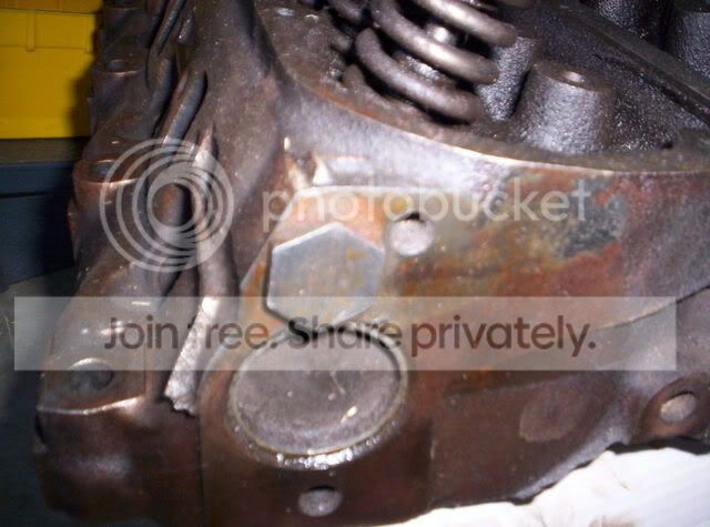

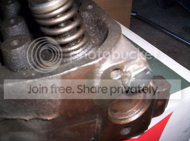

Here are the same holes plugged on my 302 E7 Heads...notice one has been tack welded too by P.O.

Pics 302 heads
Your pics look very similiar but my holes are not threaded. Is it safe to tap them? or will metal shavings get somewhere BAD!!!

The holes are threaded, just probably full of carbon. I have used bolts or pipe plugs in them.
