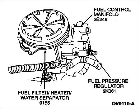

CLICK HERE for a reference picture.
You want to add a 3/16 ball bearing to the FPR. Check you Fuel pressure at the schrader valve (bicycle tire looking thing) before and after the mod. It's removed in the picture, just leave it in the FP housing. More than 75 psi may cause trouble. The fuel pressure gage will bounce quite a bit, just use the middle of bounce for you readings. You will see what I mean.
I don't remeber where I got this pict so thanks to the member I stole it from.

awsome pic....worth 1-million words, give or take a few.
I forgot who used a cotter pin....but would you just slide the shaft up inside the spring so the head's poking out? Should I try a bobby-pin?

You must check the FP w/ the engine running, our PSD's have mechanical pumps.
Shimming the fuel pressure make the engine run better and could make it run a little hotter on the EGT's, nothing to worry about. A good set of gages removes all doubts. You need gages if you are going to mod your truck.
A fuel pressure gage from a gasser will work as long as it goes high enough. The needle bounces alot so you need one that reads ~90+ psi. A dial type bicycle gage will work too but, The bike gage might leak fuel or get trashed though.
