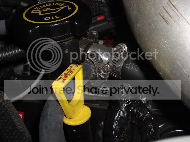

No, you don't need to drain any coolant before the install. You can minimize coolant loss by using vice grips (gently) spaced about 6 inches apart when you cut open the heater hose and install the big aluminum "T". I wound up having to replace about a pint of coolant.
Is there sandy residue in the bottom of your coolant tank already? If so, you'll probably want to swap the original filter after a few thousand miles of use. I put mine on when the truck was new, and I change the filter every 10K miles.
Edit - here is a pic of the tapped heater hose. As you can see, it runs just inside the oil fill tube.
