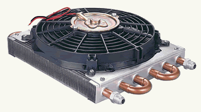

What is a pusher fan?

Old Aug 19, 2006 | 10:31 PM
stuart1's Avatar
stuart1
Joined: Jun 2003
Posts: 2,982
From: Somewhere Saskatchewan
This
http://i36.photobucket.com/albums/e1.../Fancooler.gif

stuart1; it is good to see a cooler with inverted flares for a hard pipe system (adds extra surface cooling area) instead of a rubber hose waiting to fail.

Ok fine in the air stream.
What about stop and go traffic in town?
The airflow there is diddly squat.
A pusher fan works great in this situation.
