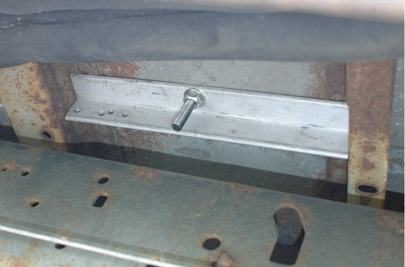

Great ideas and I've done something similar mounting and securing a Snap On tool box in my cargo bay area. Using 3/16" aluminum angles between the floor ribs I'm able to capture those ribs which gives me quite a secure mounting I believe. Like this:
BTW most factory seat bolts and welded nuts are inside the frame rails. For the most parts the right side (passenger) is a bit easier to access where the left (drivers) side can be a bit more challenging with the gas tank etc tucked under the floor along that side.

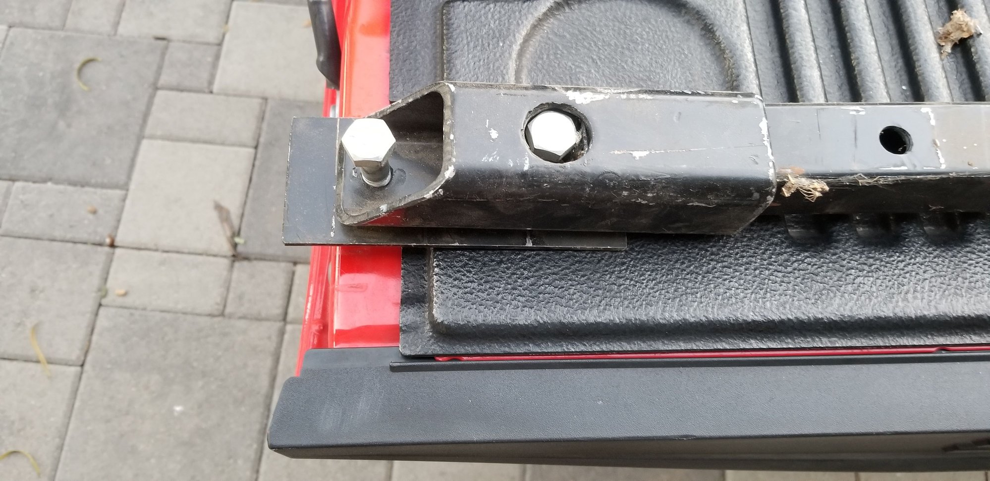

This is approximately how the setup would look as you looked in the cargo door of the van. There was a piece of angle iron bolted into the footwell which those bars were bolted to. Oversize bolts as you can see by the size of the holes.

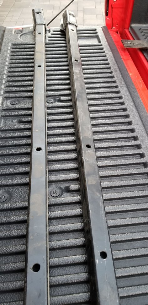

The top photo shows how the bars telescope into the next size up square tube, which was bolted to the floor near the wall behind the driver seat. Second photo is the same stuff, upside down, showing the little relief I had to put into the bar to clear the hold down bolt. "Engineer as you go".

This shows the 4 holes where the stock low backs on their pedestals were bolted to the bars. I could install and remove the whole mess by myself. No wonder I had hernia surgery.
