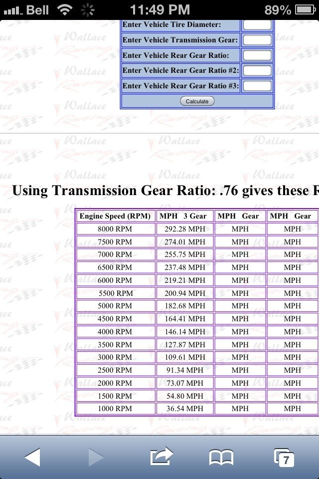

Its possible. Using my setup with 3.00 rear and ZF @ .76 OD ratio 275/60/R15 tires. (28")
RPM/MPH From Gear Ratio Calculator by Wallace Racing
