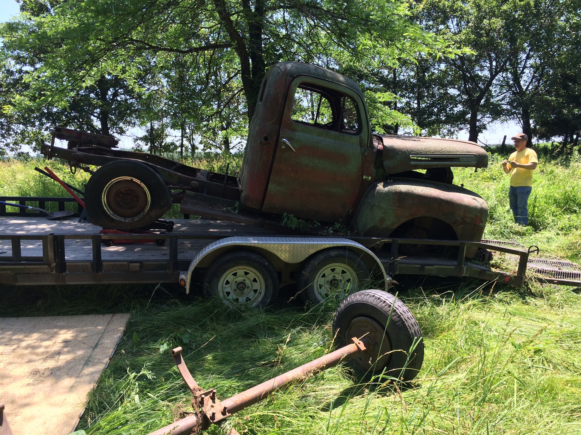

Hi guys. New to the forum. I just pulled a 49 or 50 flat bed F1 out of the woods in amazing condition considering it was parked in the woods and sunk in the dirt since before 1964.
Here is the tag info I found. I would appreciate if you could help me decode all of this.
Vin tag on pass side of firewall reads *98RC*372615*KC
Firewall stampings read 2 KC 25D277
Glove box tag reads 98RC 33 72615 (note, the first 3 is very faint and hard to read).
The truck apprears to be a F1, V8, stick shift, with Ford OEM stake bed. Originally painted Red. It has the pickup style running boards (they are longer with holes that would attach to the rear fenders) but the stake bed is definely a Ford stake bed because it has the Ford Logo imprinted on the back. The remaining wood and stake bed are the same color as the interior of the body (red) but I am wondering if the numbers show this was originally a pickup. Could the pickup bed have been changed to a stake bed at the dealership before delivery? Please let me know what you think.
Vin tag on pass side of firewall reads *98RC*372615*KC That's actually a Patent Data Plate, and not a VIN tag.
I think that first "3" is probably a "goof" by the stamper, who then redid it correctly. Other than that, your two numbers match. I suspect it has something to do with the punch used. The truck serial number FOR THAT CAB is 372615. The KC is for the Kansas City plant where it was built. The 98 indicates a 1950 as that serial number is higher than the 49 cutoff (I think)... experts should be along any minute to clarify my gibberish.

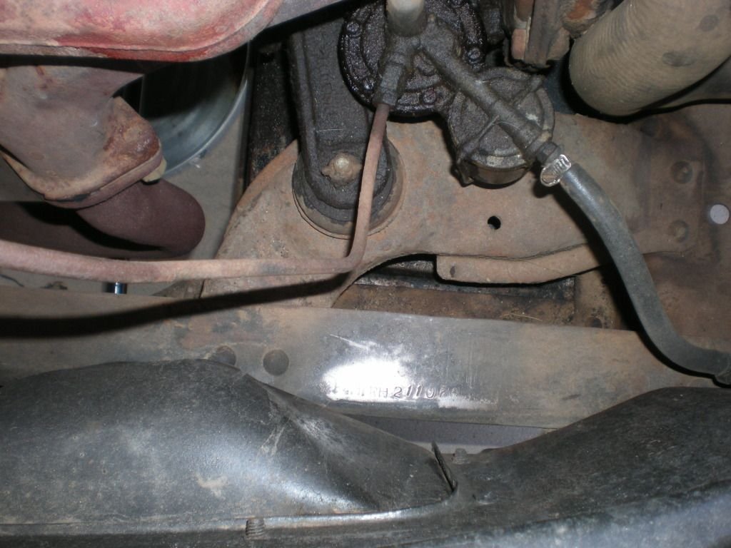

I say that is the serial number for the cab because the only valid serial number for the truck is stamped into the top right frame rail just ahead of the motor mount. If you can verify that number matches the two you've found, *98RC*372615*, then that is the correct number for your entire truck.
Here's where I found my frame stamp.

Thanks for the info. I think you are right about the first "3". I did not realize those numbers were so close to each other. After looking at the pictures again, it does seem to be a misprint in the tag.
I can't get to the frame yet as the hood is stuck in position so I am oiling the hinge points to try and get it to move. My bet is the frame number will match. The truck was parked in the woods around 1960-64 and was never touched from that point forward except for "some kid" breaking the windows out of it (that kid is the guy in the yellow shirt in the picture....I jokingly told his mom that he would not be getting away with it as I would be invoiceing him for the cost of the new glass...LOL).

Joe has the serial number.
Firewall tells:
2 - Vermillion Red
KC - Kansas City plant
25D - 25 April 1950 assembly date
277 - anybody's guess (in-house numbering system)
They made F1 flatbeds, but the length of your running boards looks like this was after-market modification. (Those would have attached to the pickup fenders - flatbed running boards are much shorter and stop at the back of the cab)
Nothing from the factory indicates what it would have been originally. Enjoy!
