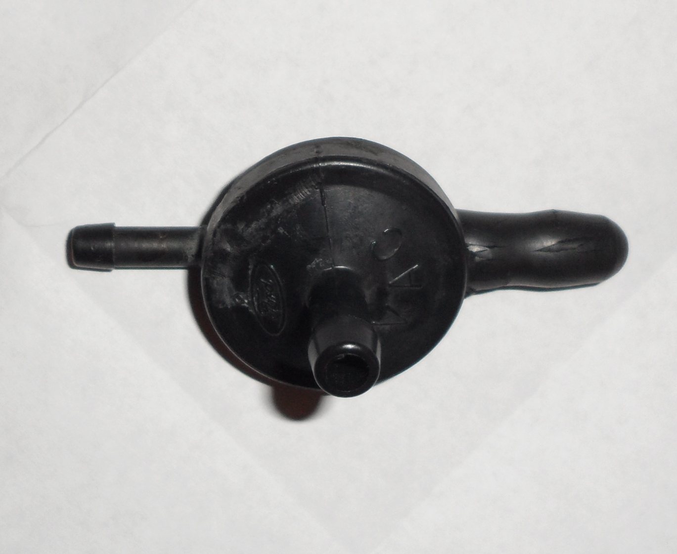

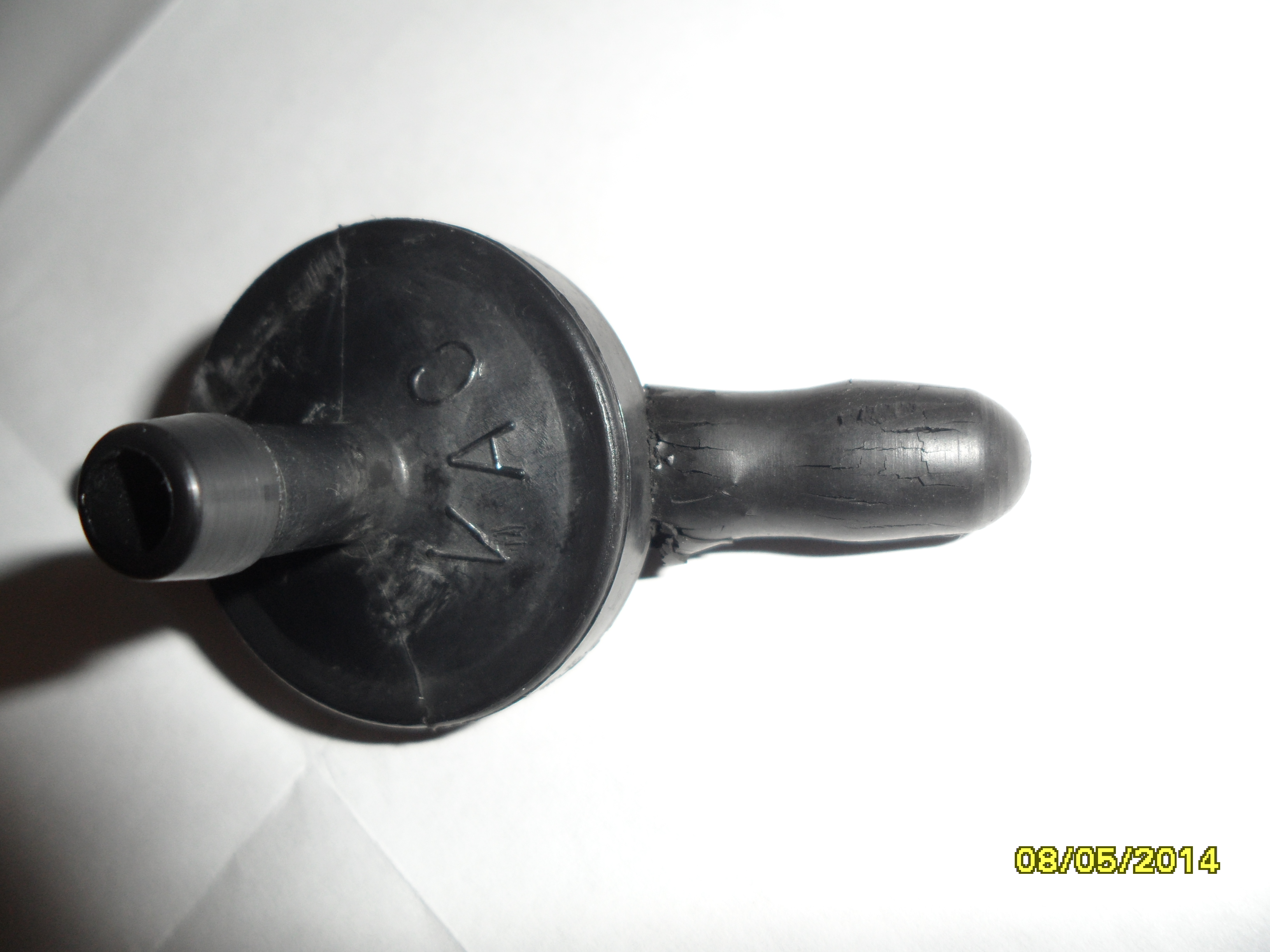

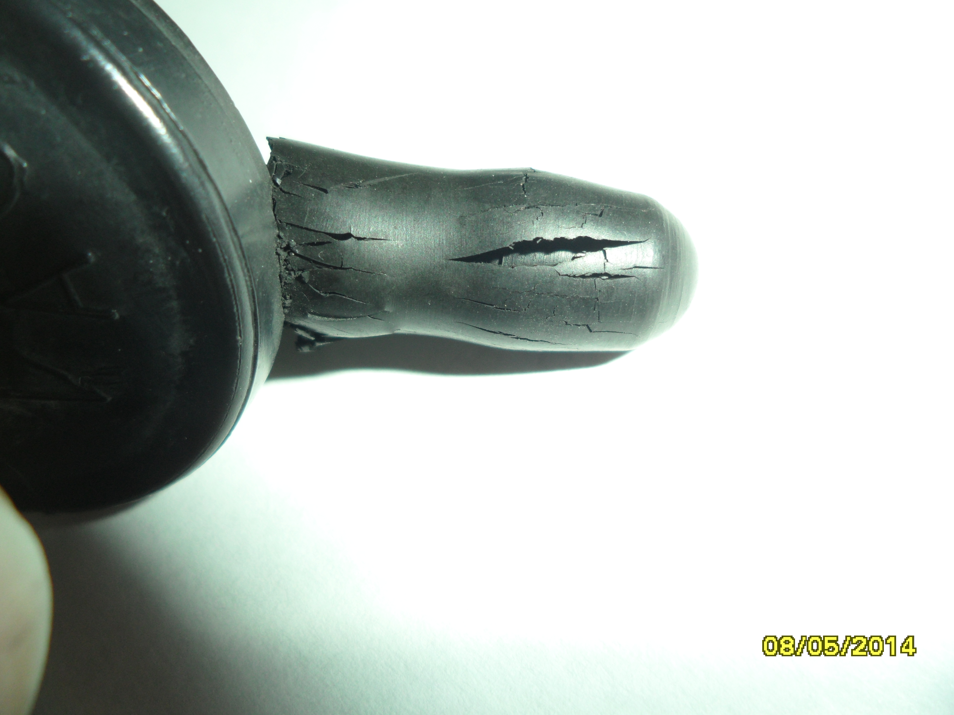

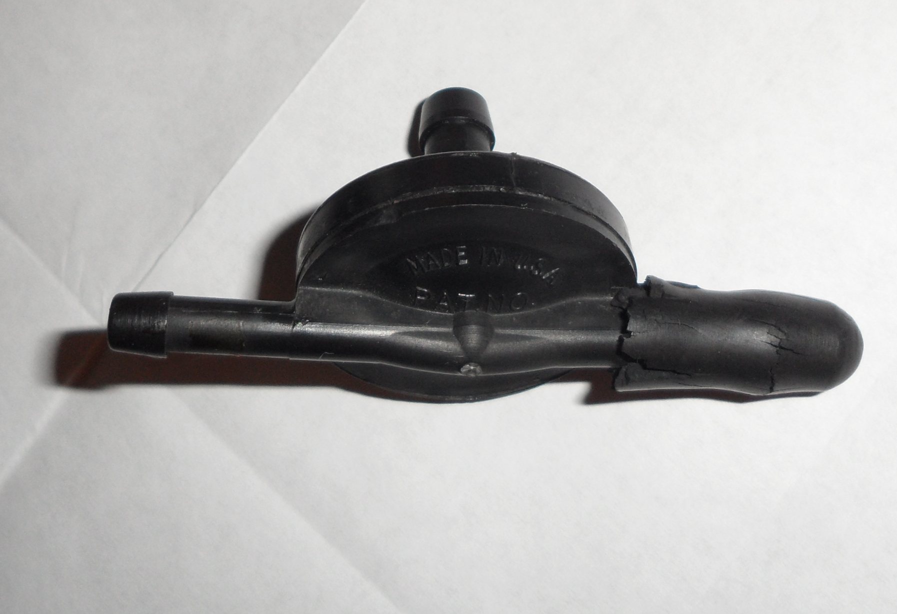

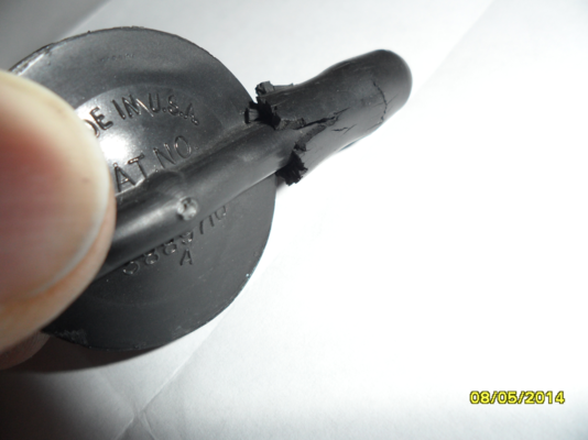

Two years ago I had replaced that check valve with a JY unit off some random Ford. Thing was, it had an extra tap. I had a pack of vacuum caps I'd recently purchased for a friend's car, so I slipped a cap on the extra tap.
Fast forward two years, I had divert-to-Defrost on hills again last week. I took a look at that check valve, and the cap had failed.
Cheap Chinese crap. How hard is it to make a vacuum cap that last longer than two years?
Click HERE for larger
I used a glob of RTV this time 'round.
