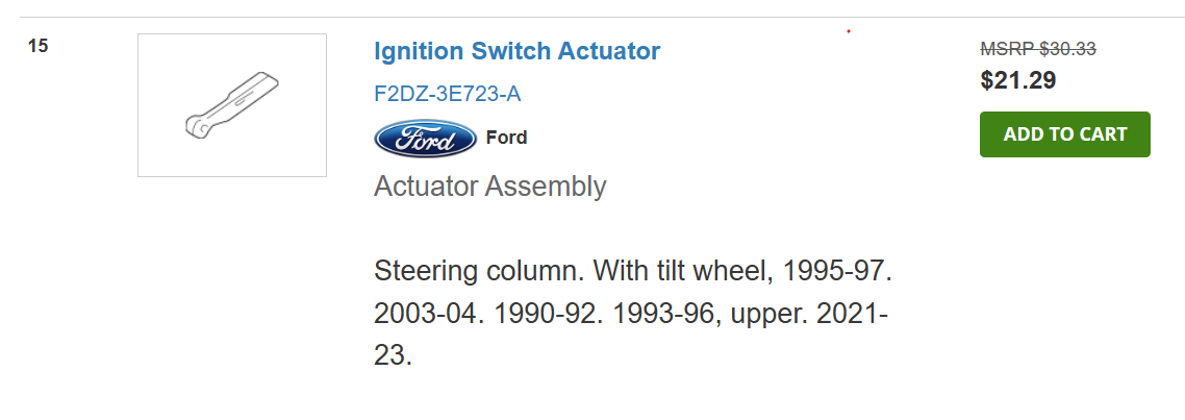

You had the pin on the ignition switch inserted into the hole there right?
Hope you have a good back, working under there sucks.
I think this is the PN
yes I'm pretty sure that is it but I can't locate any removal/install directions for it, would it be easier to remove the steering column, how much time should it take, what tools? Things like that best would be a step by step guide.

I was looking for stuff like that and found squat, just like you. I would remove the column and work on it on the bench. Minimize the pretzel factor.
But before that maybe stick a screwdriver in the hole and work the mechanism to see if it's solid? Confirm that is the real problem. I've never heard of that breaking before but it is oolllld plastic.

Yeah I did actually just tried that and that's why I am confident its the issue cause even with the key out it slides freely.
