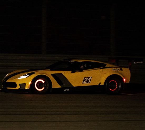

Warped rotors is one of my personal favorite auto myths. Not sure how people managed to convince themselves you can put enough heat into a steel brake disk to make it lose its shape forever. For reference, in the photo below, that's still not enough heat to "warp" steel rotors! And it happens over and over and over!
I want your Corvette. That aside...dealerships and certified mechanics say this over and over and over. They cut the rotor, put it back and the issue reoccurs because it wasn't warped to begin with.
