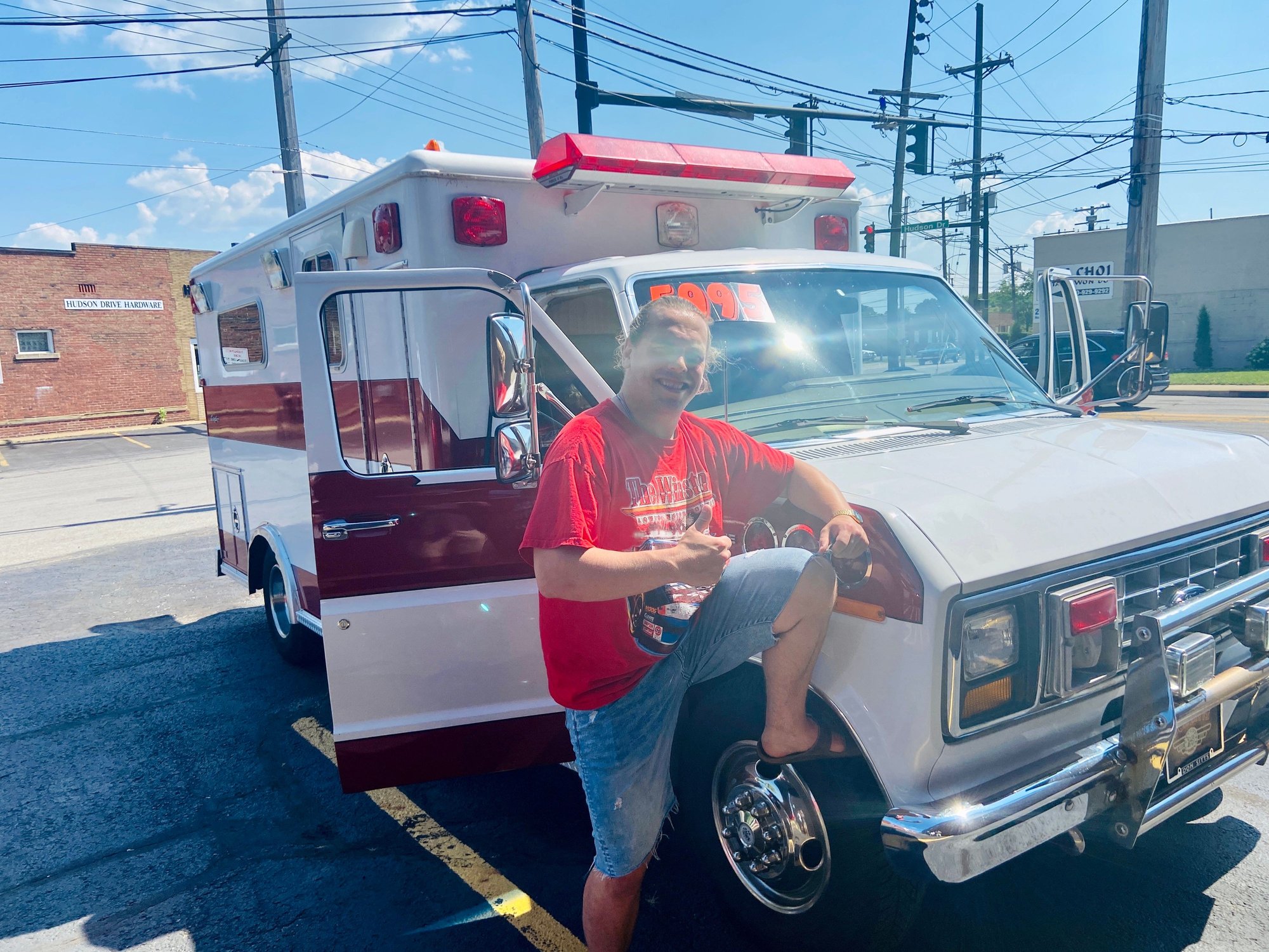

Replying to this old thread because it references a vehicle close to one my son wants to purchase. So, my 22 year old and some buddies want to buy an ‘88 E350 7.3L with the ambulance package and only 29,000 original miles. It seems like both a ridiculously cool idea and a ridiculously bad idea. The sale price is fairly low so that part of the financial equation isn’t too much of a concern. My bigger concern is that it’s 32 years old and just huge. I’m trying to provide some guidance... any input would be appreciated. Wondering the GVW on this rig, what he may pay to put plates on it, insurance costs, etc. - I’ve told him if he’s serious, he needs to have a mechanic friend of my check it out. What things should my mechanic look for? Maintenance on a 32 year old ambulance can’t be cheep. Also, what kind of mileage does a 32 year old ambulance get - 6 MPG???

My immediate thought when seeing the photo of the grinning young man is wondering if he's thinking or pre-calculating how many buddies, beer coolers and young women will comfortably fit inside this thing? Its the same thoughts I'd have so maybe I'm just projecting? Something like that in my hey day would have been a dream come true........
Depending what jurisdiction this ambulance served its entirely possible it has only 29K actual miles---in a small enough town with few runs 29K might be a lot of miles. Condition-wise it probably needs a lot of remedial work on hoses, belts etc etc but if the mileage is actual not much else should have failed. I'd have the A/C system checked but if its been carefully maintained that should be operating fine now.
The ambulance portion is another story especially if the more important medial components or systems were removed without care. I would think the siren was removed as that could be a nuisance in the hands of young men--again maybe just projecting.
The price is right, it could possibly be negotiated downward a bit but its fair right now. I would talk with a trailer hitch shop to get their impression on its real-world ability to tow something. I can't image a small single-hull 16' boat (or similar) would be a problem--hauling a 50' mobile office would present issues I'm sure. Since its probably a dually stability shouldn't be an issue--whether the current suspension can really handle a hitch and tongue weight would be an issue and concern.
BTW I'm figuring no less than 3 total buddies, minimum 4 40qt coolers and 10 young women---as a rough estimate.
