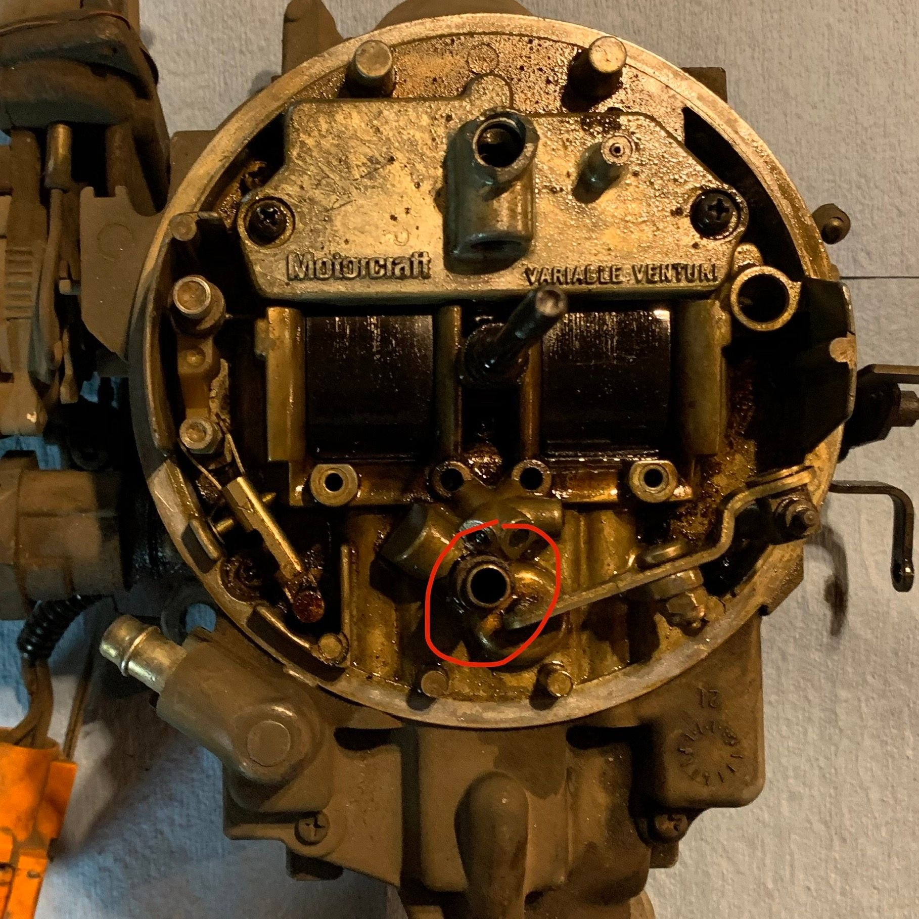

Sorry for the old thread bump. Just rebuild my VV carb on my ‘82 F150 302. Reinstalled and when running it is dumping gas out of the port circled in red. Looking at the parts diagram I’m not seeing what is below this. Before I pull it apart again, any ideas? Float stuck maybe?
PS: photo is from before I cleaned and rebuilt it

You have a stuck Float, that is the float bowl vent.

If it keeps sticking and overflowing, even though you keep taking it apart, you might have fuel tank problems. Little rust flakes get in under the float needle and hold it open. When you take the carb apart, look down in the bottom of the bowl and check for brown rust.

The bowl was pretty clean when I got the air horn off. Of course, I still cleaned the crap out of it and used compressed air anyways. The needle provided in the GP Sorensen kit was a little longer and I didn’t replace it. I’ll take it apart again today, replace the needle (bend the tabs to correct for the new length) and double check float height. Thanks for the info all!

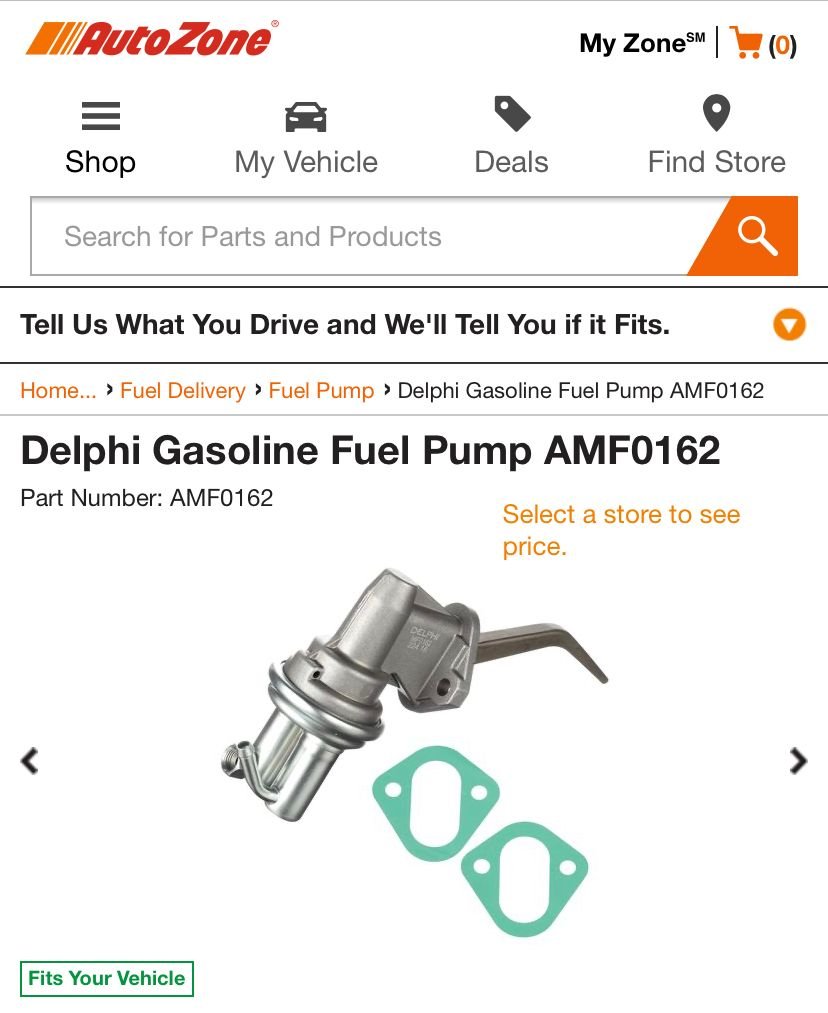

I replaced the fuel pump earlier this year. Looked like a direct replacement from what I was pretty sure was the original. This is the one:
The truck has 74k original miles on it. Been fighting a poor running condition which has deteriorated and I finally bit the bullet to rebuild the carb. I miss the simple carb on my F100 (not CA truck!)

Then psi should not be an issue.
Some run electric pumps and some need a regulator to work with some carbs.
Dave ----

Carb rebuild all good, thanks for the ideas. Stuck float was the culprit. Replaced the needle and reset the float to spec, no more gas everywhere! Carb seems to be running well.
Still have the stalling issue which I’ll try to find in another thread. I believe it’s electrical in nature. Thanks again for the tips everyone!
