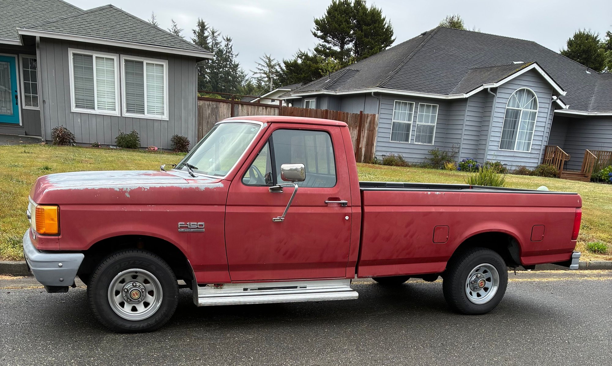

Just drove this 8hrs home from Seattle ! One question I have is about the e4od overdrive off switch… did every truck come with that switch? Mine is missing and I don’t even see the wiring for it inside the dash area.

If the truck actually has an E4OD transmission there will a switch on the dash to disable 4th gear.
Why do you think this truck has an E4OD?
What is the Trans code on driver side b-pillar?

trans code E

Did you seem to have an overdrive trans? After driving 1 minute, let alone 8 hrs, you'd know haha. The trans pan dont lie. Get a look under the truck and look at the trans pan. E4OD says "metric" right on it. If it only shifted 2 times and you didn't feel a converter lock, someone swapped in a C6.

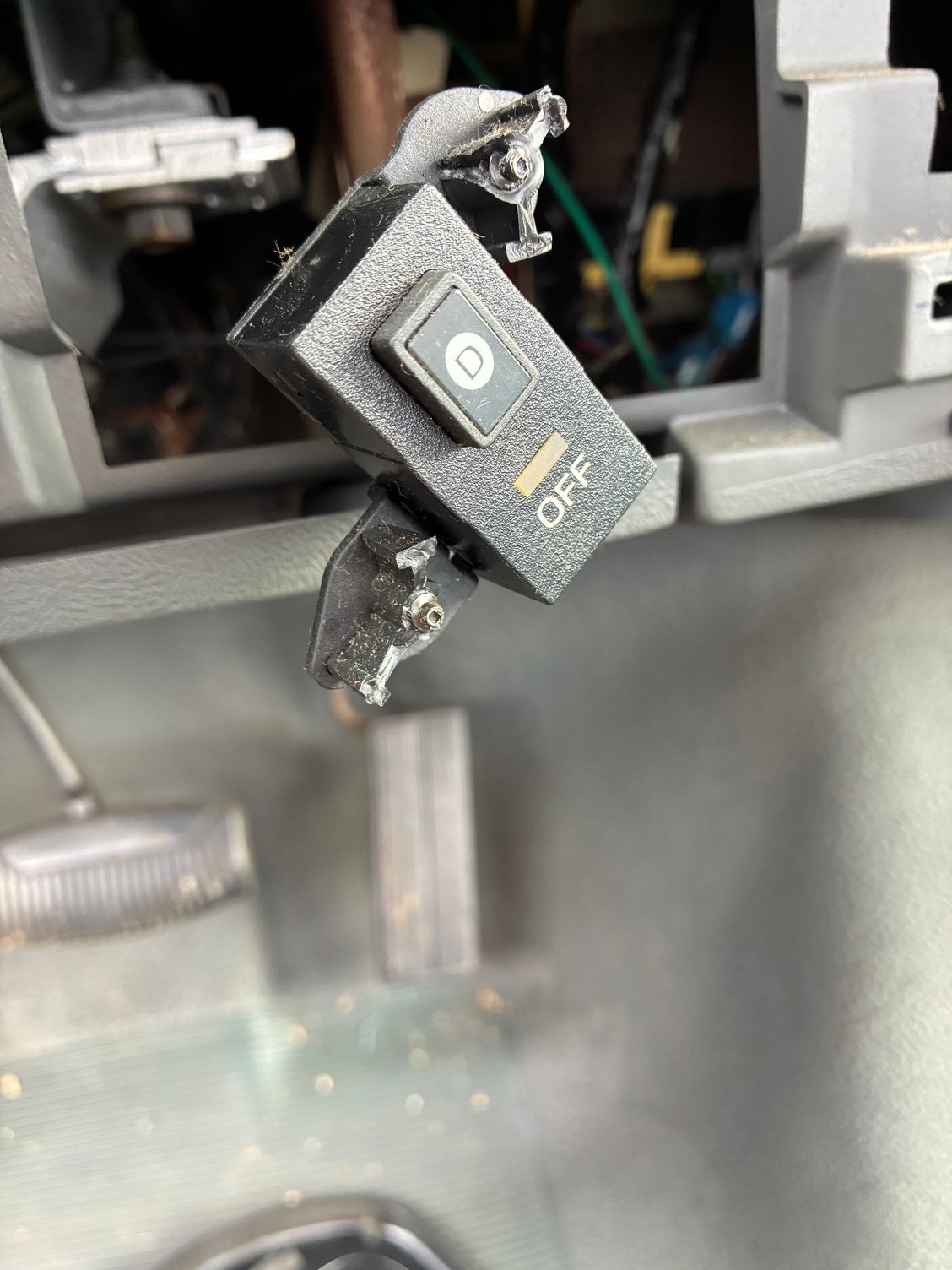

I found the switch ! It broke off and was sitting behind the trim piece. Rigged it back in place

that aint no riggin, that is a purrfeshional fix. riggin it would be using crazy glue and bailing wire!!

thanks ! Do you happen to know what the red light is that sits to the right of the overdrive switch ?

got a picture? i have had C-6 in all my trucks, so do not know where the OD switch would be.
