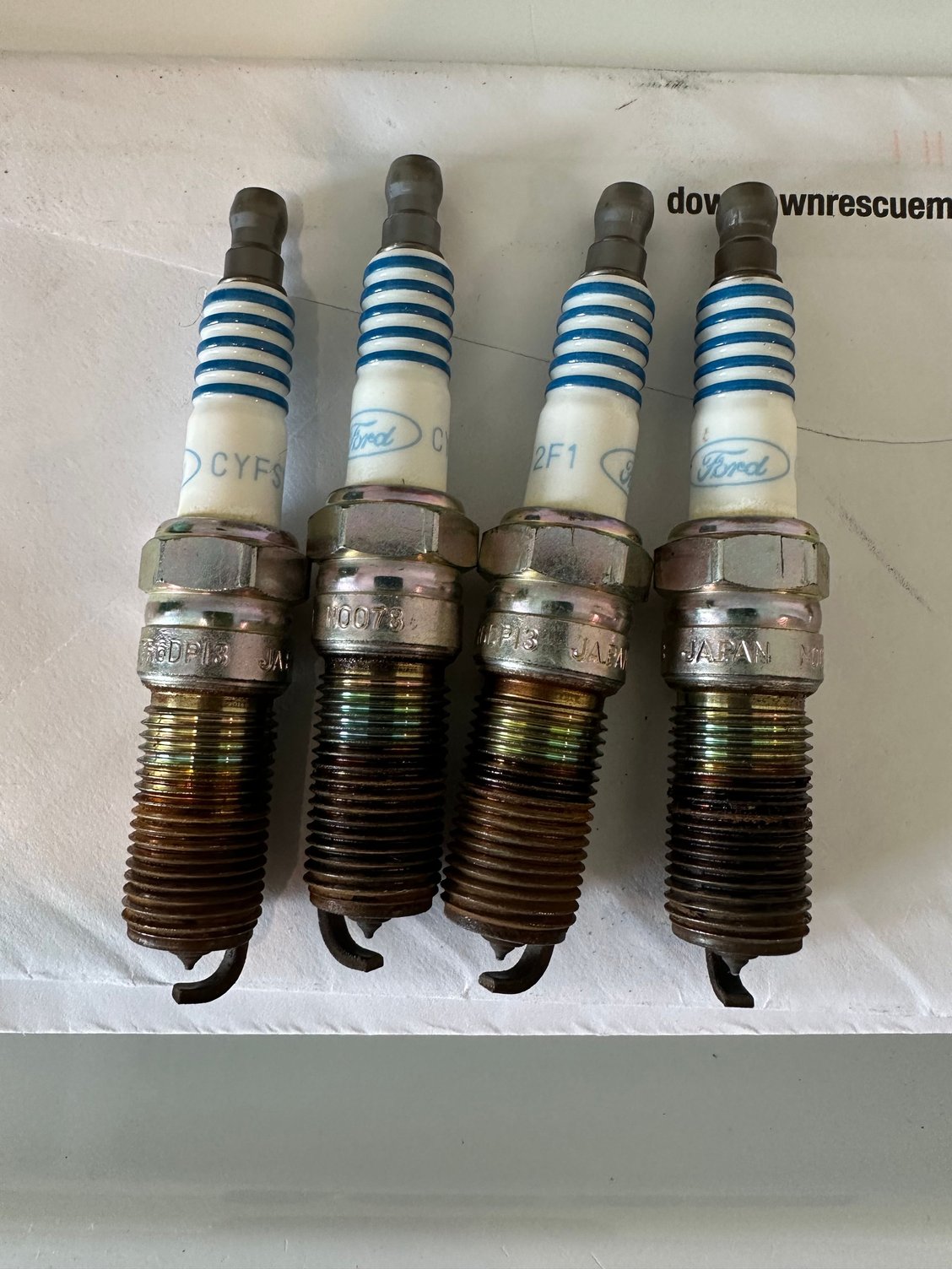

My 2016 F-150 XLT 4x4 5.0 was due for spark plugs, and I went ahead and swapped them out. Problem is with those pesky coil connectors. I was able to get them all disconnected without much trouble, but I notice after having installed the new plugs and boots, and reattaching the coils to the head, I'm having trouble getting the connectors to click into full connection. Even after sliding in that final plastic piece on the top, you can still slide the plug off of the coil. I believe that you have to listen for a click when you slide the plug onto the coil, and then you slide the white tab until it clicks, right? I thought I had the job completed but now I get a check engine light and a rough idle. I'm sure it has to do the those connectors. The truck was running well before I changed the plugs, but at 62000 and never been changed, they were due. See pics. Thanks for any advice on this.
Here's what the old plugs looked like.
