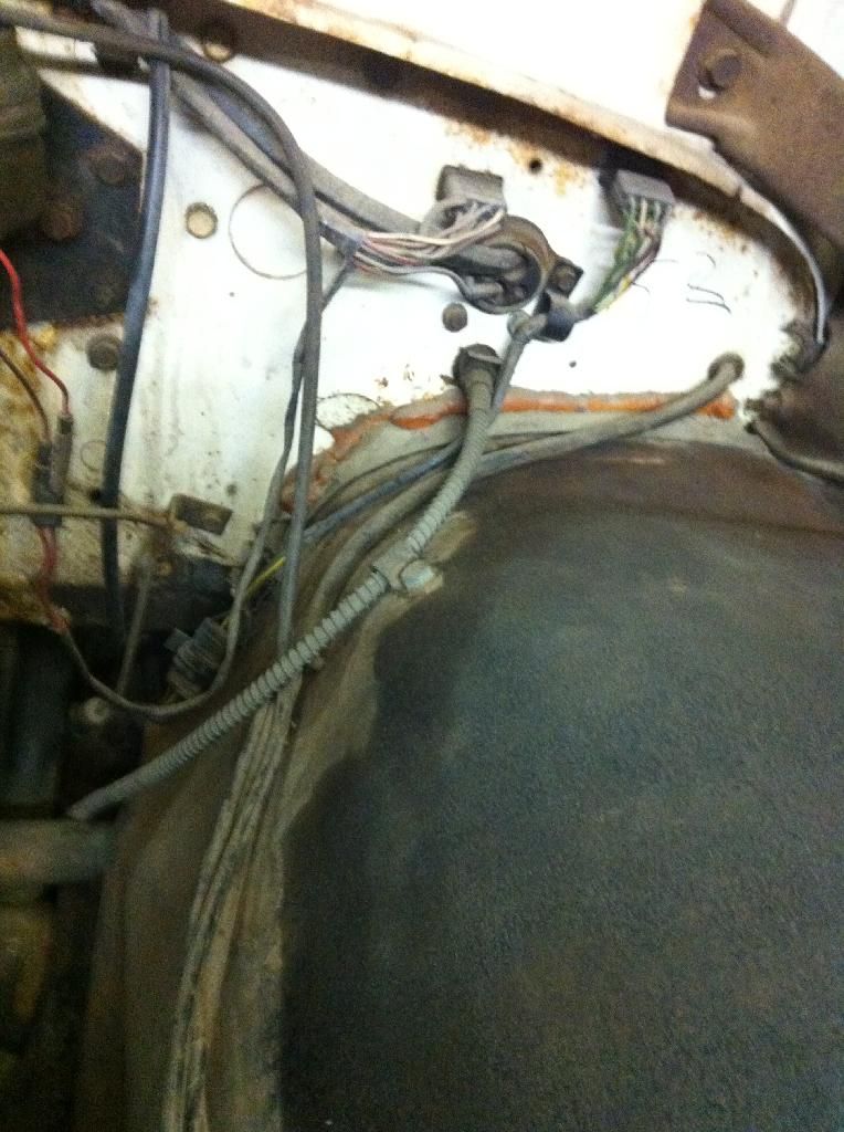

I should have taken better notes. Anyhow, I removed the parking brake cable and now I don't know if it's routed inboard of the steering box (towards the engine) or snakes underneath the steering box and up the inner fender. A little clue would be helpful. thanks in advance. I do know that there is a clamping point on the inner fender but don't know for certain the route it takes to get there.

Outboard of the steering box is correct. Snakes down into the frame channel from above.
