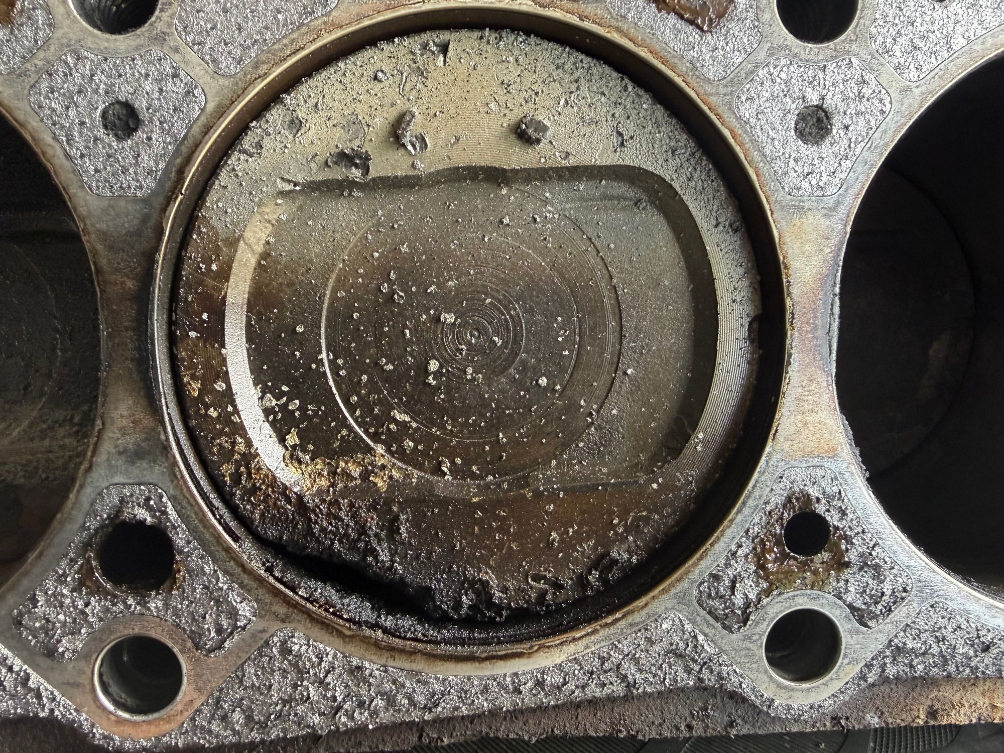

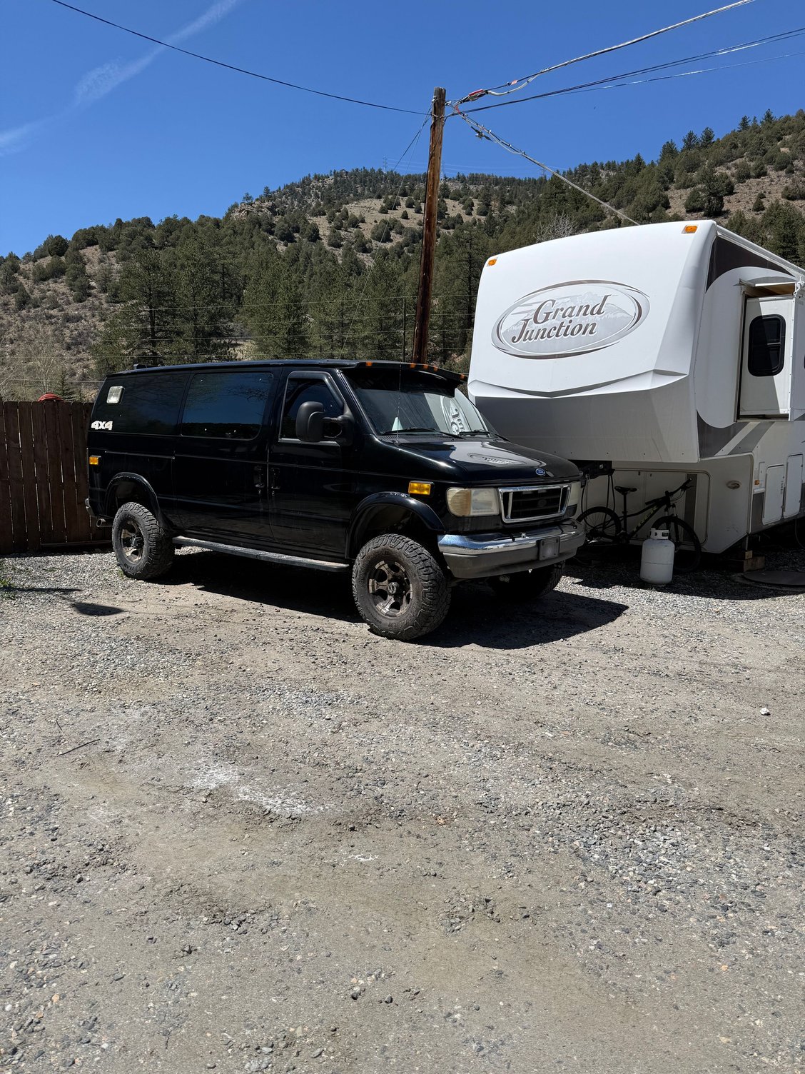

Hello all. I own a 93 e350 with a 351w. Just recently purchased, and in the process of an engine rebuild since one of the pistons was destroyed for some reason. Upgrading most things while I am at it. Flat top pistons, and aluminum heads with 60cc compression chamber to bring up the compression ratio to approximately 9.5:1. Heads have a 175cc intake runner, plus a new roller cam for added low end torque. Also a MAF conversion from Fiveology.
