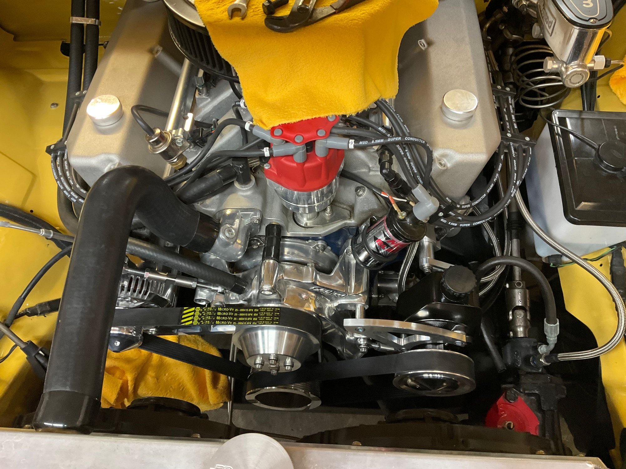

I run the pro Flo 4 on a stroked 428 (462) and love it!

Not to hijack, what are your hose clamps?
