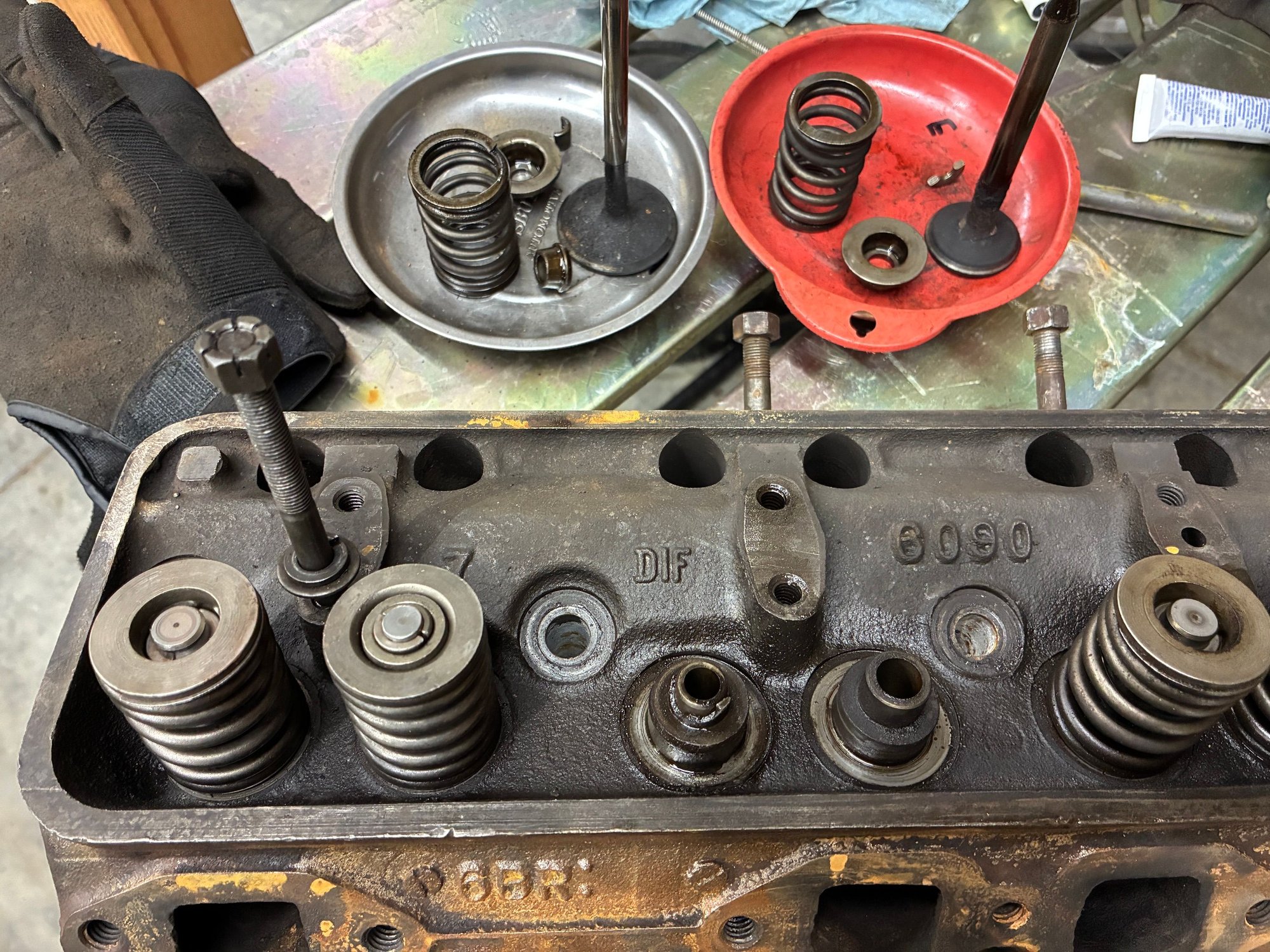

Here is my head with two valves removed. It only had seals on the intake, so I would assume that is the best way to put new ones in.
My current ones are hard as a rock.

Joe if I recall correctly that motor came from a BIG TRUCK. Your photo looks to show the exhaust valve stem larger than the intake, indicating it's sodium filled. I'm no expert but have been told that sodium filled valves should be handled with care.. in the past they were used to dissipate heat better than solid valves mainly used on diesel, and big truck engines.

Good info BJ. It's actually the exhaust valves that are probably sodium filled. The larger comment threw me a little. The head of the valve is larger on the intake, but the shaft on the exhaust is larger (indicating sodium filled)

Just an interesting tidbit where Ford documentation tells you to discard sodium valves by burying them or sinking them to the bottom of water bodies and to not deal with them as traditional scrap metal.
