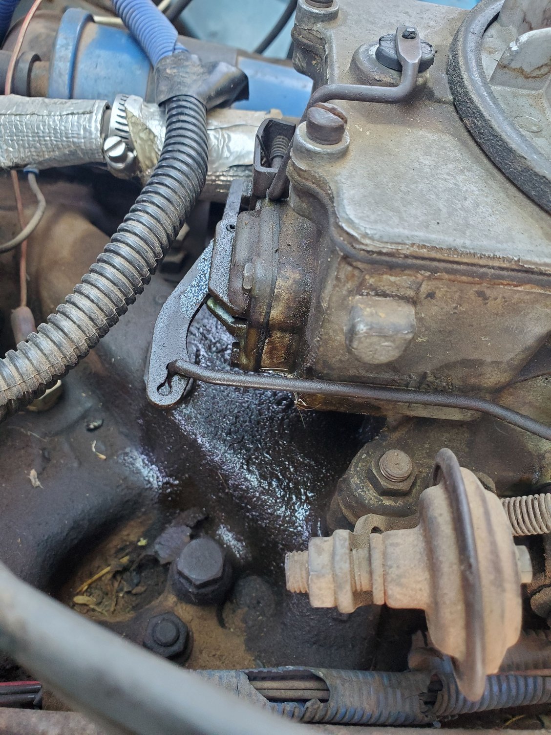

I think this note was confirmed as I installed the pump, no leaks at the pump end...tested the electrical...all good...fired up quicker than usual, no leaks at the pump but running slightly rough...so I look at the carburetor and it's absolutely pouring out of the throttle pump area where it's never leaked before.
So, now I will bypass the mechanical pump and test again.

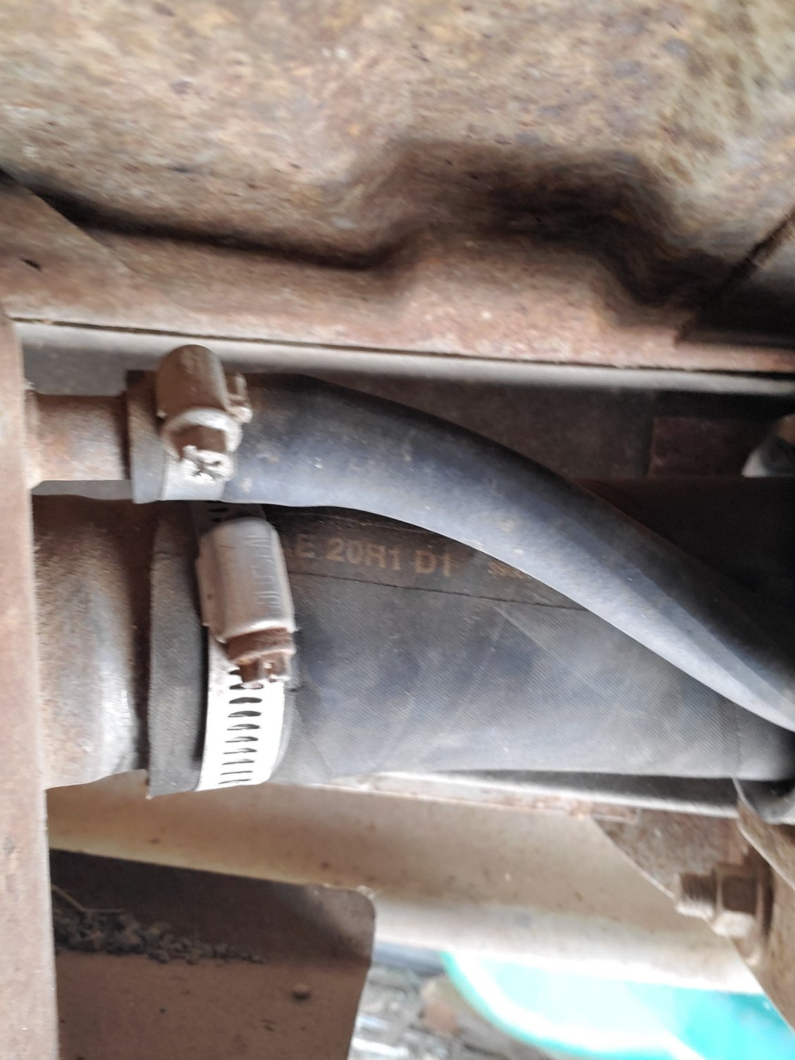

While I was under there I realized there is a tank vent that I can use to have a vapor return line.

Looks like that old 2bbl just needs a carb kit with a new power valve and cover gasket
And a new accelerator pump
Clean that intake off, all spotless, where it has been leaking so you can watch it closely as you run it when you're done
good advice. it never leaked there until this electric pump. I have a rebuild kit I'll throw at the carb once I test this bypass out. "spotless" is going to be a challenge.

My fuel path is not ideal but it looks to pump at 5psi.
Old May 9, 2026 | 08:20 PM
Oggy Bleacher's Avatar
Oggy Bleacher
Joined: Mar 2016
Posts: 45
Looks like the accelerator pump leaks still so I think the carb was due to be serviced at the same time as using the electric fuel pump so coincidence it failed at the same time. Or the diaphragm in the accelerator pump can't take 5psi. I'll find out soon with a carb rebuild
