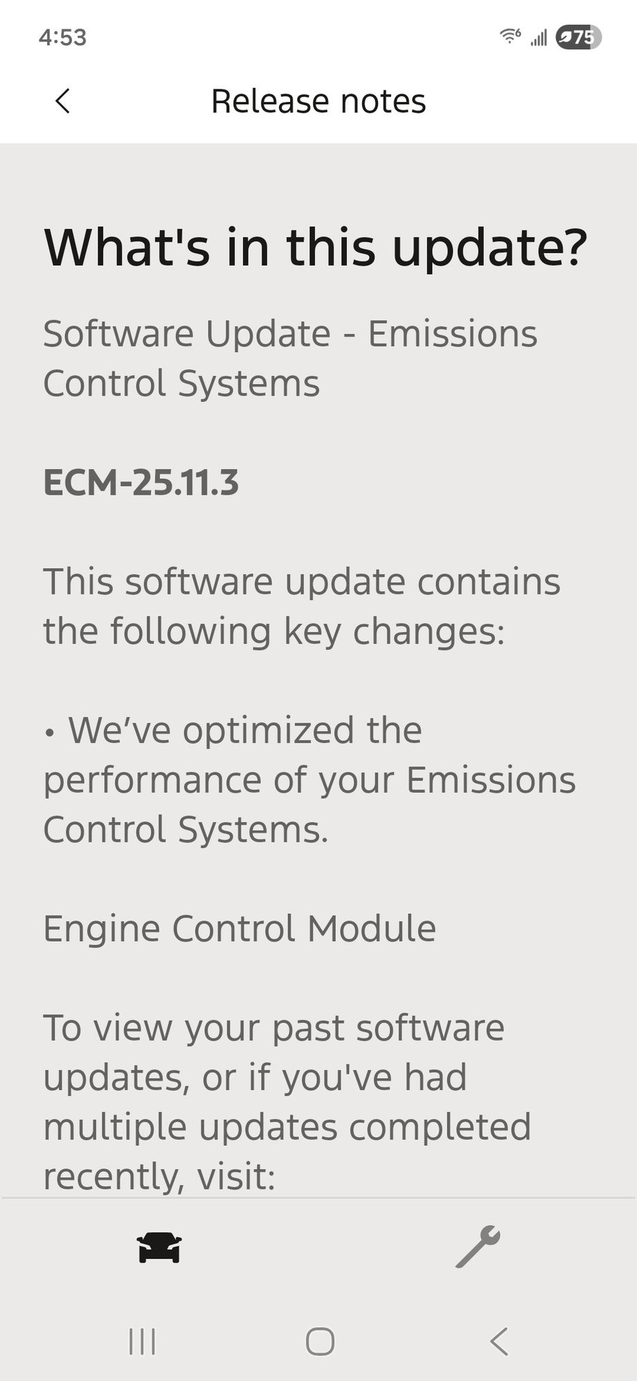

Mine dropped in Thursday
friday I went to see what changed and reconfigure the my view screens
Thursday dte was 672 and full tsnl
Friday it read 377...still showing full tank..which it was
this morning on way to dealer for trailer break and ecm recsll the dte continued to drop
And never recovered my lost 300 os so miles to dte
mpg still read 19.4 in all three screens
Hopefully it chooses to reset, it was 19 miles to dealer
Def is at 62...surely the update does not look at def as a point of reference now for dte
Like it does in trailer tow???

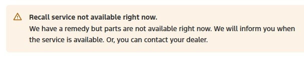

Is that recall different from the trailer module recall for my '22? Mine says:
yes trailer brake and pcm
But pcm had already updated ota
