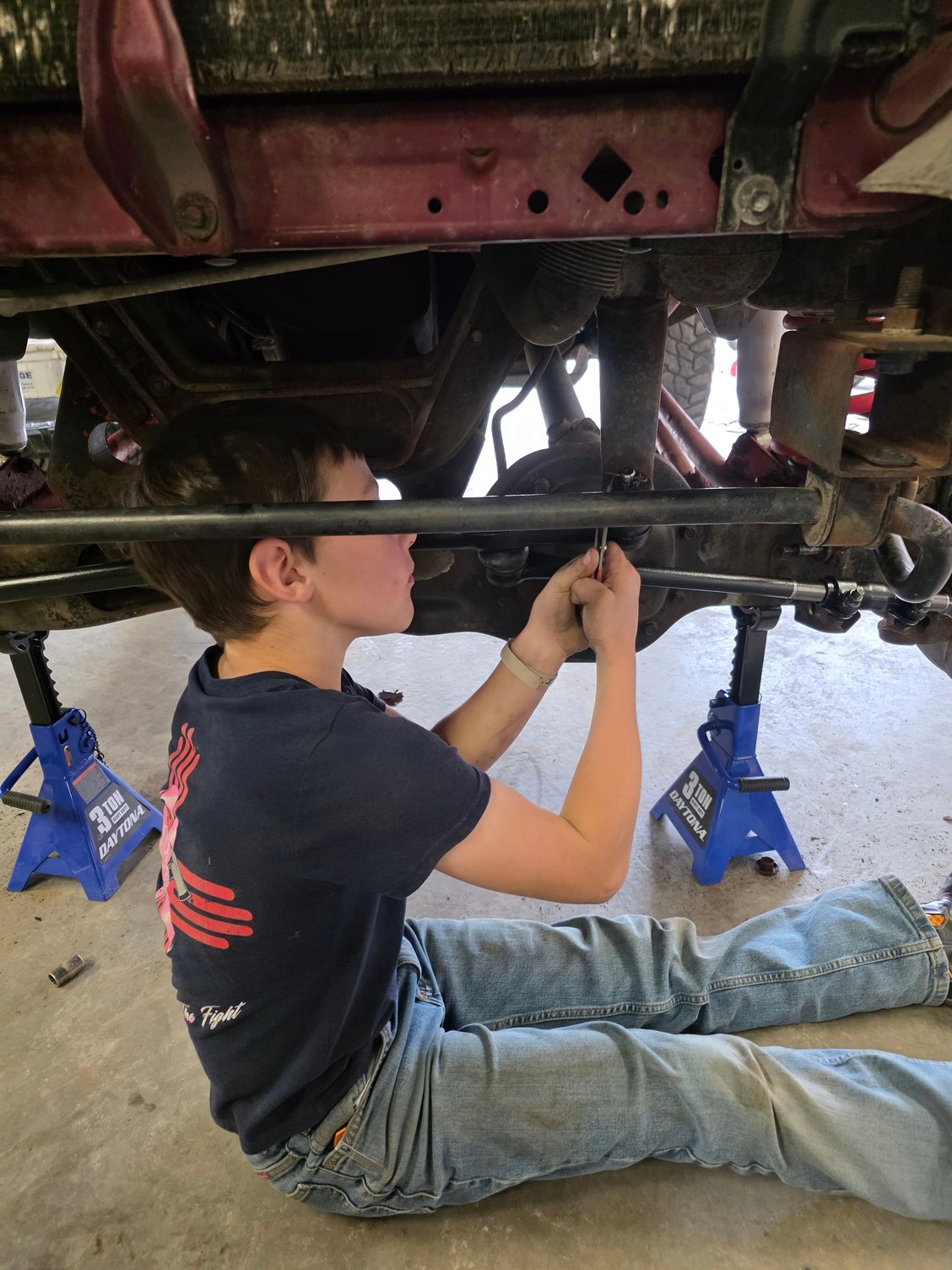

I discovered that the steering box is not completely centered. I can turn way sharper towards the passenger side than the driver. The limiting bolts behind the knuckles are not the cause. I did just replace the steering the linkages, but I didn't move anything to make it out of wack that far. Leads me to believe whoever installed the lift messed up when centering the box. It still works off road just fine. We took it out for Mothers Day and the steering angles weren't an issue except MAYBE in one obstacle. I'll get around to dropping the drag link and centering the wheel/box.
Anyway, I have installed new steering linkage. I bought the XRF F250 components after reading good reviews on XRF. They had a good price on eBay from American Undercar. They are an authorized dealer for them, and its cheaper than buying directly from the XRF website.
https://www.ebay.com/itm/186331709556
I also replaced the rear shocks with some leftover stock style superlift shocks. They came with the lift kit for my wife's F150, but we upgraded to Fox's. I've had these sitting on the shelf for a few years and they were virtually bolt in. They are 1" longer than the blown Skyjacker shocks that were on there. They aren't permanent because I think they were limiting our flex and upward travel quite a bit...
We also found some good 35's on sale from Walmart. Kanati Mud Hogs for $187/tire and mounted them on some 15x10s from our parts Bronco. My little helper put in some work polishing them back up.

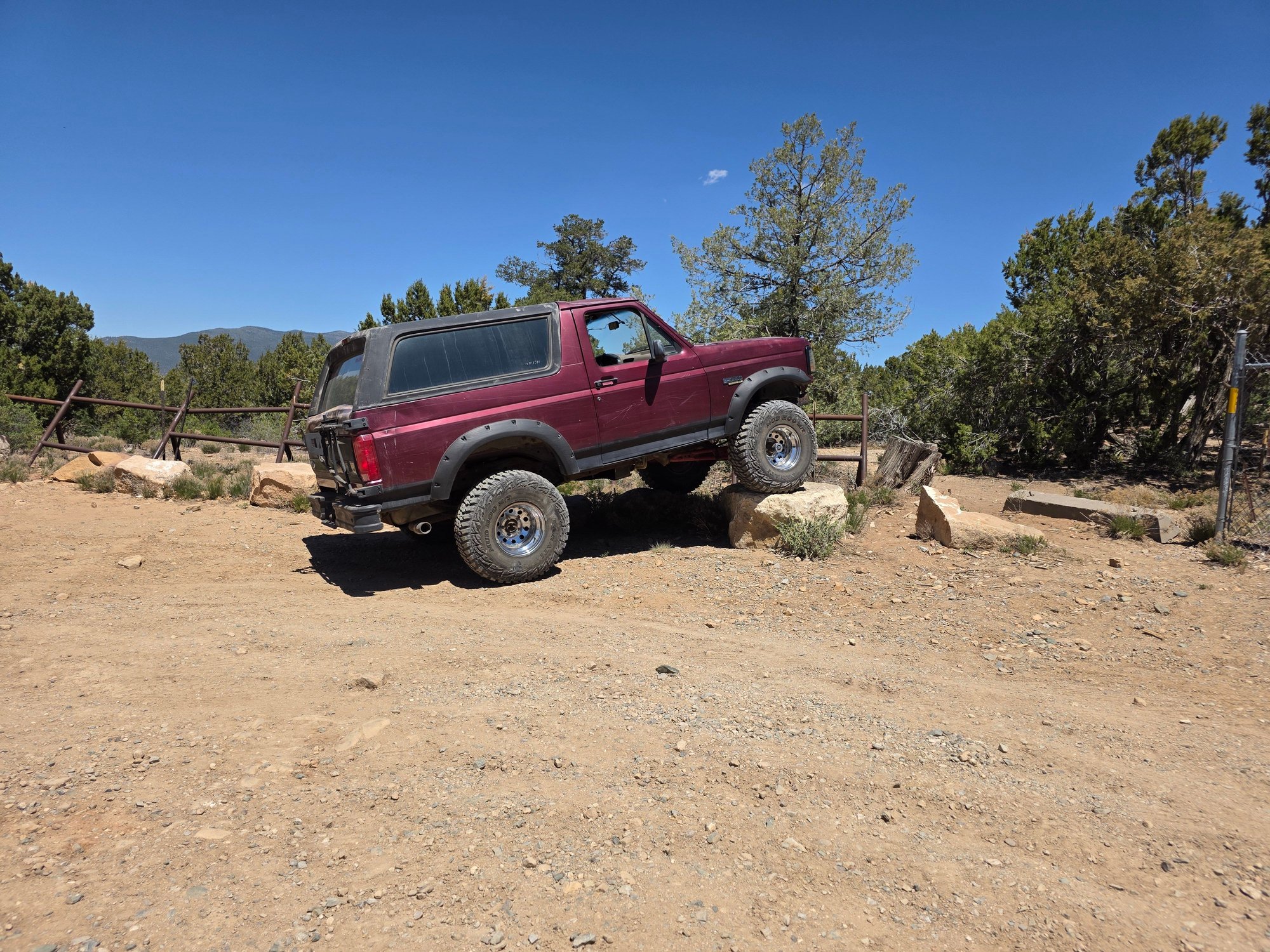

A little bit tippy right here. Pictures don't ever do this stuff justice.
