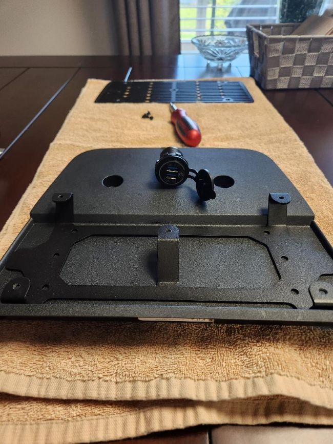

What's the best bet for 12V switched at the top of the dash in my 25 F350?
I'm installing this socket to power my trailer backup camera screen and my phone.
There must be a 12V switched source somewhere without taking half the truck apart or having to be a contortionist.
