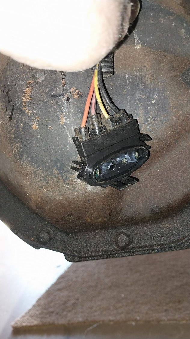

If you don't already know, and if you need to, you can ground out pin#6 on the ODB1 connector and both pumps will run at KOEOff. I had to do that to hear my Lpump run in the tank and i could jump 1 at a time because there is a splitter plug under the shield that's under the master cyclinder. I was able to use a 4 ft wooden dowel to unhook the pigtail on the fuel tank to work on that plug.

On mine for example, the Lpump would run for about 20 minutes, until that plug got hot becuase of the faulty connection. When the Lpump did not work, then there was no feed to the reservoir for the Hpump. The Hpump was trying to pull from the tank, it would barely run, the fuel pressure was a sketchy 8-10 watching it on the guage.
