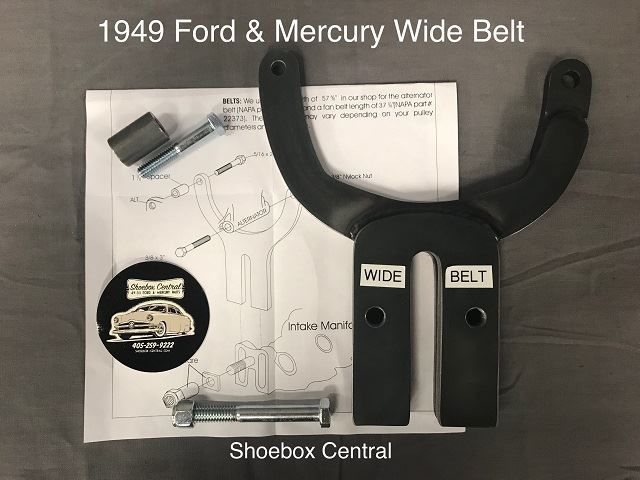

Look at the bracket Shoebox Central sells if you have a wide belt setup. Looking at the right side of the picture you’ll see that the bracket is stepped. It does a better job of accommodating a 10SI alternator without having to modify the alternator. I bought one that’s flat from Speedway and regret that decision, ended up buying one of these to get my belt aligned better.
https://shoebox-central.com/1949-for...rnator-bracket

@Christopher2 , speedway was very transparent with the fitment [emphasis theirs]:
The other wide belt specific options you and I listed definitely are much more suited for the wide belt setups.

I agree with you on the other solutions. I also read through Speedway’s notes about the required modifications, and that part didn’t bother me. I should have been able to remove the standoff part of the wide mount boss.
My first red flag on quality control was during mockup—the machining was so rough that the alternator wouldn’t even fit between the mounting ears. I had to hit the casting with a bench grinder just to get the alternator to bolt up.
Once I got it mounted, test fitting showed the pulley was too far forward. I ended up removing the entire wide boss protrusion I circled in green and ground it flush with the rest of the mounting surface. That was every bit of 9/16”, and I’m still off by more than 1/16”.
At this point, based on where things sit, that dimension really should have been somewhere in the 1/2”–7/8” range. The only way to correct it further would be to machine a recessed notch into the wide boss itself, which I’m not willing to do.
After the fact, I found the wider shoebox-style belt and already have one ready to install. I’ll end up adding spacers back in to move the alternator forward and get everything lined up properly.
  1. To use this bracket on a wide belt car or truck you would need to cut approximately 1/2" to 5/8" from the wide boss on the base of the alternator. You would also need to cut a similar amount from the spacer supplied with the bracket. This must be done to get the alternator pulley to line up with the drive belt.
