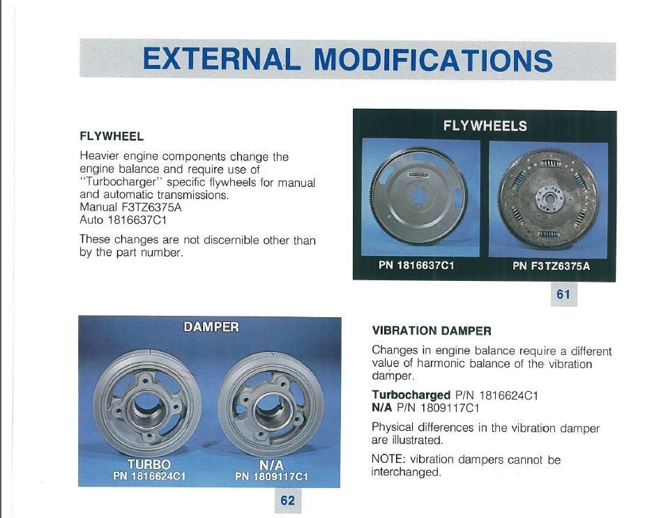

The factory ones would have been E code. You may want to check your IP numbers. Find out what that is too. You may want to investigate to find out if you have a factory '93/94 turbo engine swapped in and stripped of it's turbo, or if you just have turbo parts installed. If your truck came from the factory with an N/A engine, the 8th digit in your trucks VIN will be an "M".
Ford / Navistar Stanadyne IP Model #'s w/HP Ratings - Complete IDI Tuning Info
You really need to find out which engine you have, because they are balanced differently. They, as we know now, needlessly made the internals stronger on the less common '93 and '94 factory turbo engines and the crank is balanced very differently from the N/A engines and require different parts (balancer/flywheel/flexplate), should you ever need to change them.
If those parts are ever interchanged, the engines are strong and may last a while, but eventually, they would shake the engine right apart, I'm sure, so it's very, very important you find out what's going on to be 100% of what you have.
