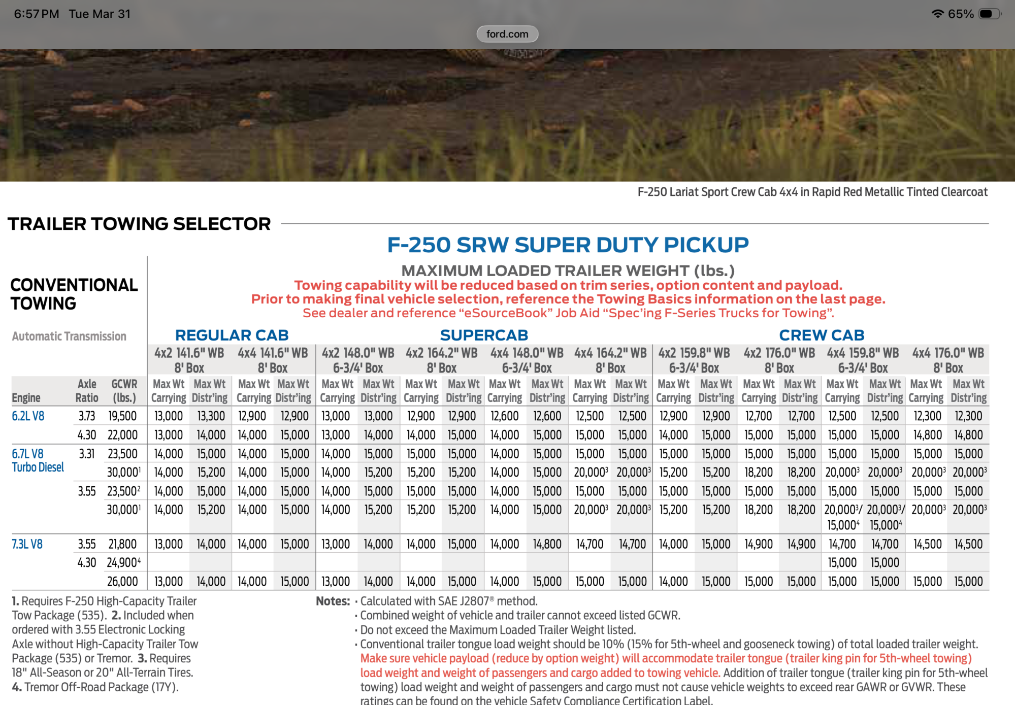

Real numbers are always higher than the manufacturer tongue weight. Manufacturers calculate their tongue weights empty and without added accessories.
What trailer?
Which hitch?
As mentioned above, are you planning on using a WDH? If you DO NOT count on the RV dealer to set it up correctly. Final adjustments need to be made at a scale to make sure all the payload, axle, and hitch weights are in line. I have NEVER seen an RV dealer properly set up a WDH.
The obvious answers to shifting weight are how you load the camper, or using a WDH. The other option is to possibly go to a stronger hitch if the surrounding structure, axles, and tires, and payload will support it. Remember, everything you put in the truck takes away from payload.
Bob
ETA:
here is what Ford says about your truck.
