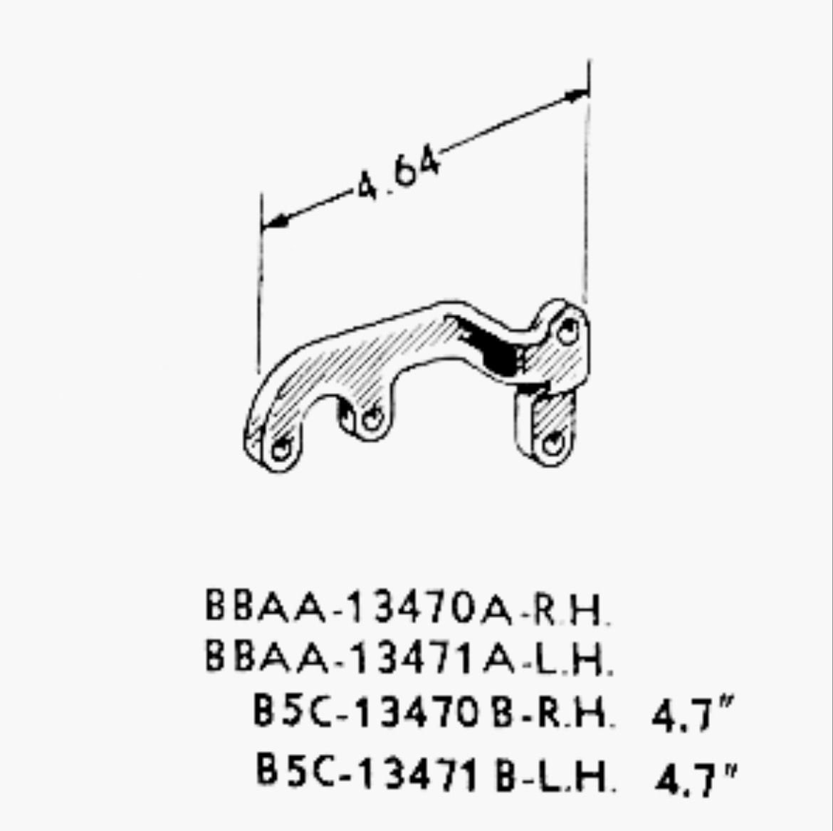

Originally Posted by bmoran4
55 made use of the B5C options pictured.
So they used the B5C-13470 and 13471? That must be because the Ford shield tail lights that were introduced in 1955 were wider than the 53-54 round lights?

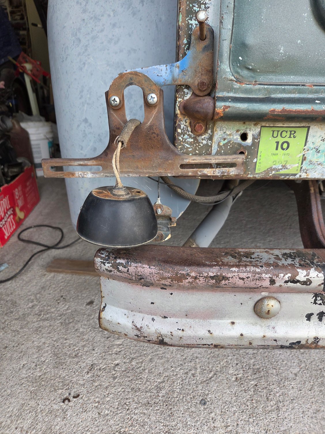

Just so I fully understand - the bracket in the photo below is for 53/54 with the rear bumper - correct? The one pictured is the right hand side? And, yes, it uses the third hole.
I can see how that would work and now, like Abe, I’m on the hunt for both the right and left side brackets. I got the ones I have on my truck from Mid-50s, and obviously these were the only ones reproduced. Recall, I never saw my truck’s originals as the rear bed brace was added in the 50s - 20 some years before I bought it in 78.
My 54 is 100% stock - well, not without the right tail light brackets…. Let the hunt begin!

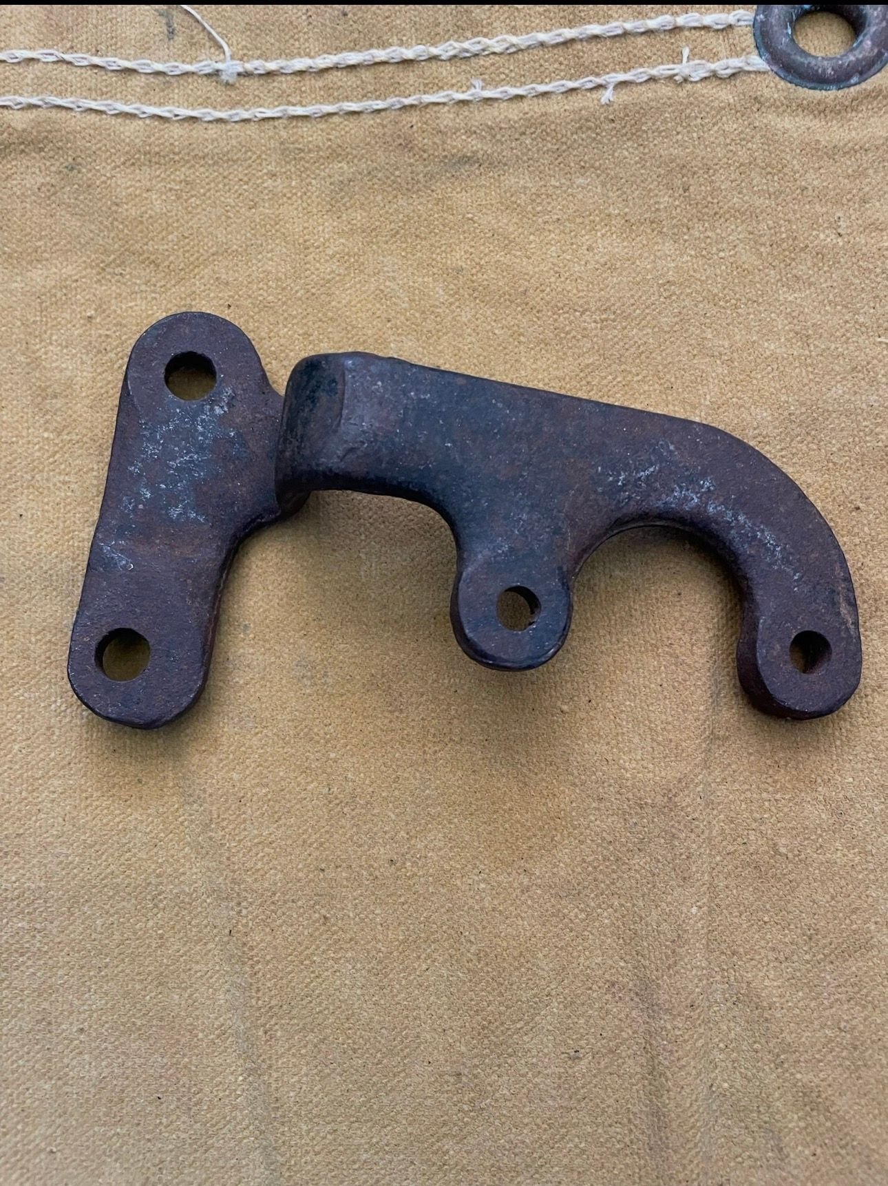

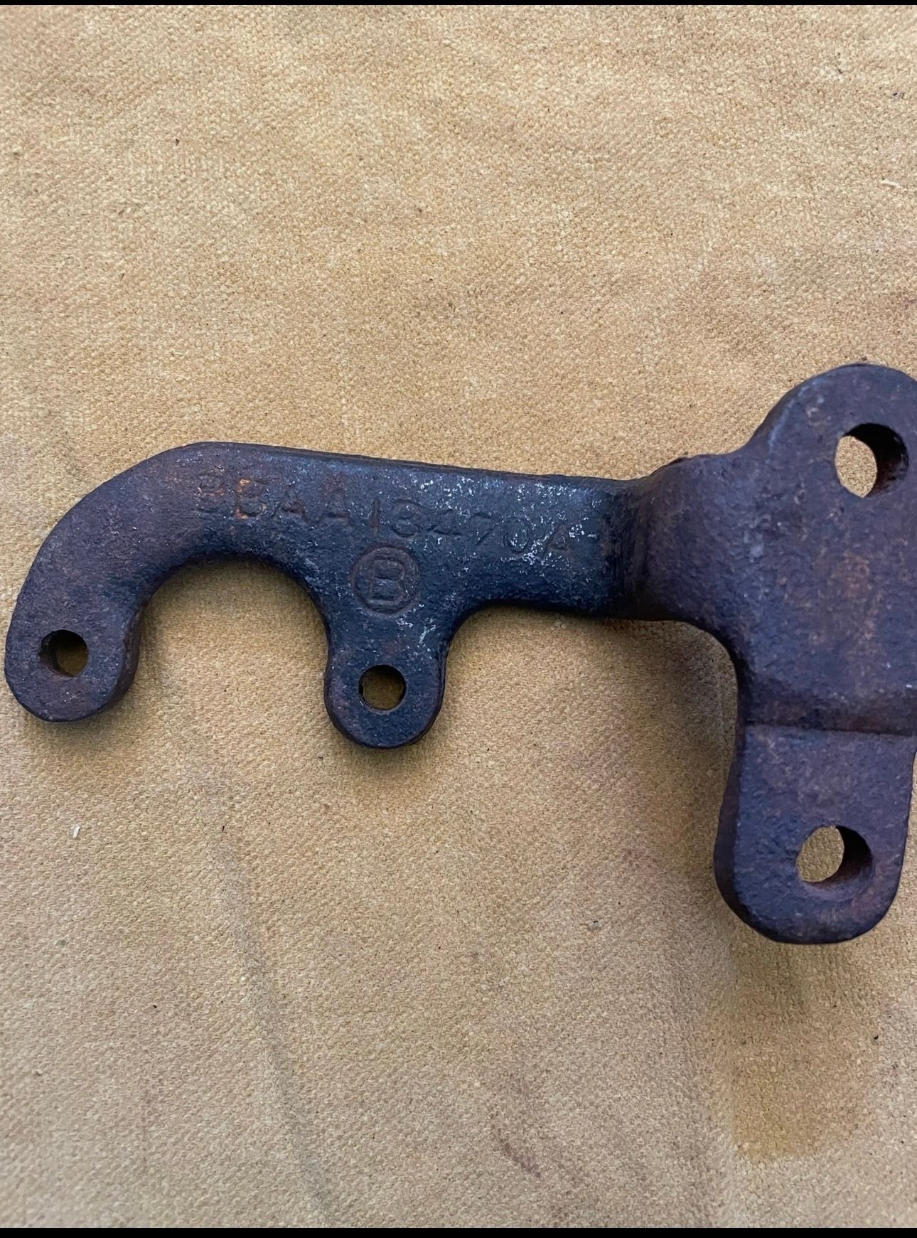

I think you got it right - there is no question the one photographed in the following excerpt from 52Flthed is the correct right hand bracket (with the left hand being a mirror) as it has the expected part number on it.
Originally Posted by 52Flthed
I have one original 53-55 bracket pictured below.
With these brackets your plate can be legible and yes it uses the third hole that is in every factory correct stake pocket.
53-55 ford original brackets part number is stamped on the back

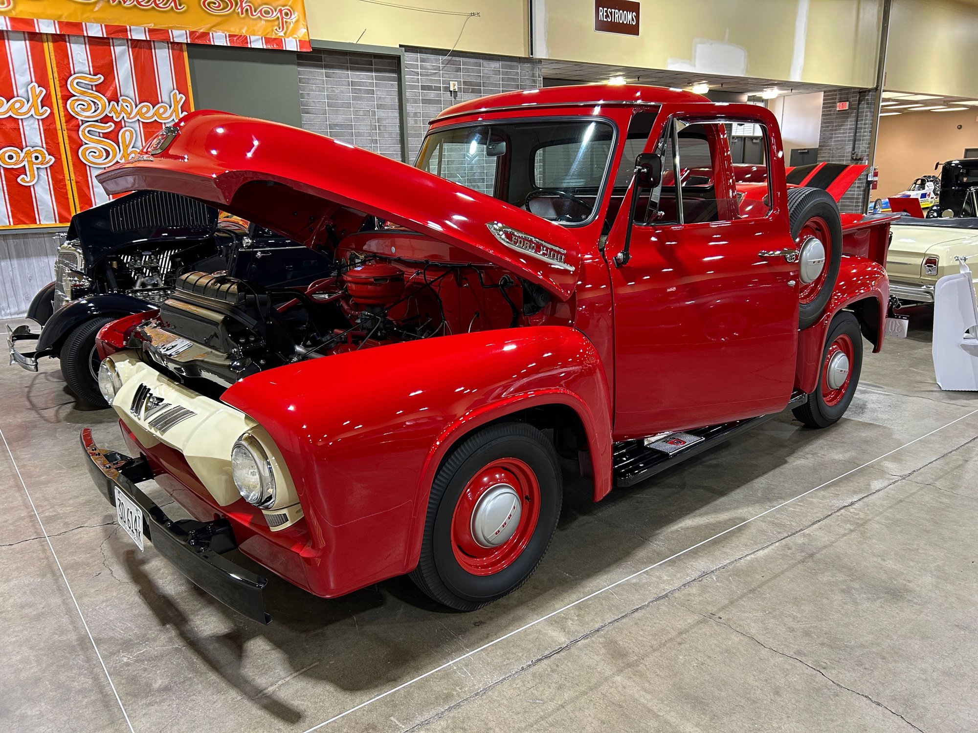

Wow! What a beauty!

Based on the parts catalog and the images of the brackets in the catalog, it’s clear that our obscured license plate is not a factory issue. The root of the obscured plate is that the correct bracket has not been reproduced, so those that needed new brackets (like me) had to purchase the wrong brackets.
It will take time, but I will find the correct brackets for my truck.

Brian, I'll give you first dibs if you find one. I don't want to bid against you. But if you find 2 let me know. Remember 55 and up truck brackets will be ok for 53-54 trucks. I think they are a bit longer to compensate for the shield tail lights. I wish I knew this when I was going through my local JY. There were several 53-56 trucks in it. I assume 57 and up flareside pickups with rear bumpers would the brackets....

So decided to tackle this on my truck. The spacing on the stake holes are wider than my truck and my license bracket needs to go up another inch. So 52flthed what is the height in the middle of your license bracket and what is the spacing of your stake mount holes? My plate bracket is 5.25 high. Checked with midwest early ford and the one they sell is also 5.25. I know I have the wrong brackets but I thought it would just be a matter of putting a shim under the top mount bolt.
