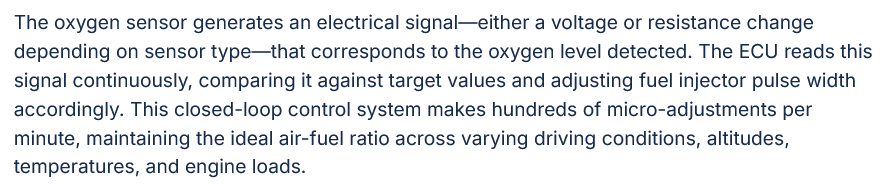

CLICK HERE - https://repairsadvisor.com/blog/how-...-sensors-work/

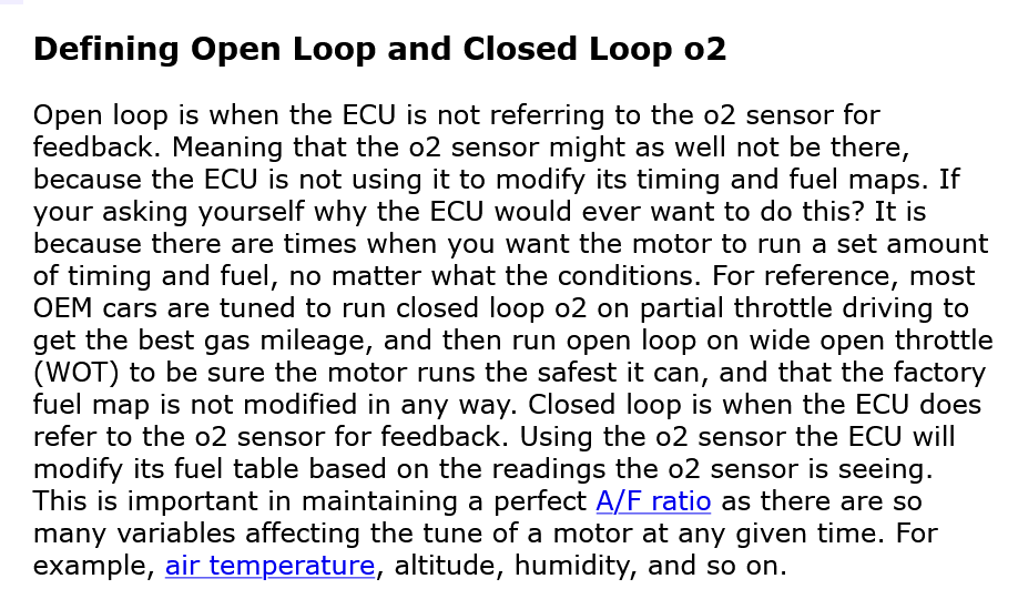

CLICK HERE - https://enginebasics.com/EFI%20Tunin...Loop%20o2.html

Originally Posted by 1Butcher
I tell you what,
You already have ...
...when the weather warms up, I will disconnect both of my O2 sensors and send a picture of my A/F gauge.
But in the mean time, the picture below shows what my factory coding on my 5.8l MAF/EEC-IV/OIL2 strategy. it's only at/above half load that the fuel mixture is richer than 14:1. Yes, different computer have different settings and I'm not saying you are wrong, I'm just showing you I'm not wrong.
Then why did you post NOT TRUE?
Are you describing an unmodified OEM SETUP or something that has been modified in some way or another? Why an A/F gauge??
