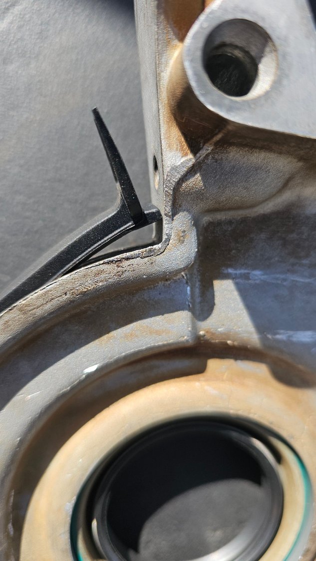

Here are some pictures of how I trimmed up the lower gasket.. this is a felpro kit but no real good instructions or detailed pictures. I had to trim the cork so it will align the hole when it touches the block. I also trimmed off the end tabs and even took a small chamfer cut since the cover has a radius there. then I trimmed the cork to fit inside the tapered rubber legs.

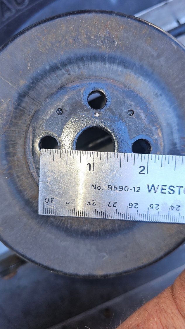

oh Crap!!! I put 3 gallons of fluid in of the 4 I drained. No leaks... thats the good news. With just 2 hose clamps, 8 bolts to go, (4 fan 2 thermostat, and 2 shroud) ! so close and then I cant get the fan bolts to go in!!!.. The flow kooler pump bolt pattern is larger that stock and my pully wont fit..
I feel sick. I'm hoping there is a pully with a larger pattern diameter?

you bought wrong pump, find the pulley for the year pump you bought and PRAY that its the same diameter and the same 2 serpentine belt slots. if not, you need to either downgrade or upgrade to the same years pulleys which may or may not be the right thing
you could also replace the pump again
Or try and enlarge the holes on the pulley as minimal as possible to put the bolts with washers.... or use 1-2 bolts you CAN get in, then find the center of the 2-3 other holes, and fill in the metal with a threaded insert or drill and tap. alll of this wouldnt be suitable in situ.. so removal. or new pump.

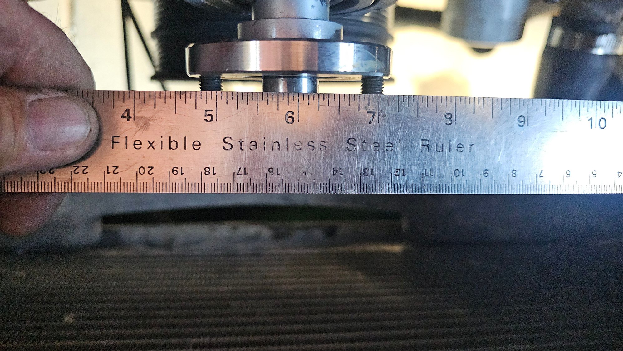

the newer clutch fans have 2 bolt patterns on them.. the 91 and 96 are same Napa part #. I picked one up .I will have to drill new holes in the pulley or elongate the old ones 1/8". or find a new or used one with the 2.12" bolt pattern.
believe me if you ever did this 460 pump you would do lots to avoid changing it out ever again.
Elongating the hole with a rat tail file wont be all that hard. its not a bad solution. it is centered by the .75 pilot on the pump. The clutch mounts on top. maybe 300 passes with a nice rat tail file.
